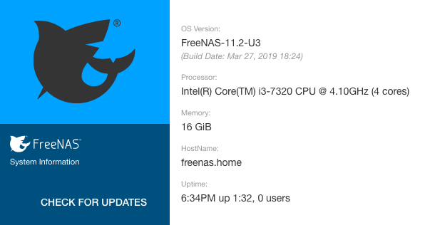

After some issues with 11.2 releases on my test systems I decided to move on and updated this machine to 11.2-U3
So far, so good. I'm happy and until now haven't had any issues. (did a fresh install, no update!)

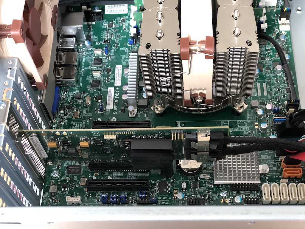

(detailed view of the LSI 9211-8i, it's working just perfectly)

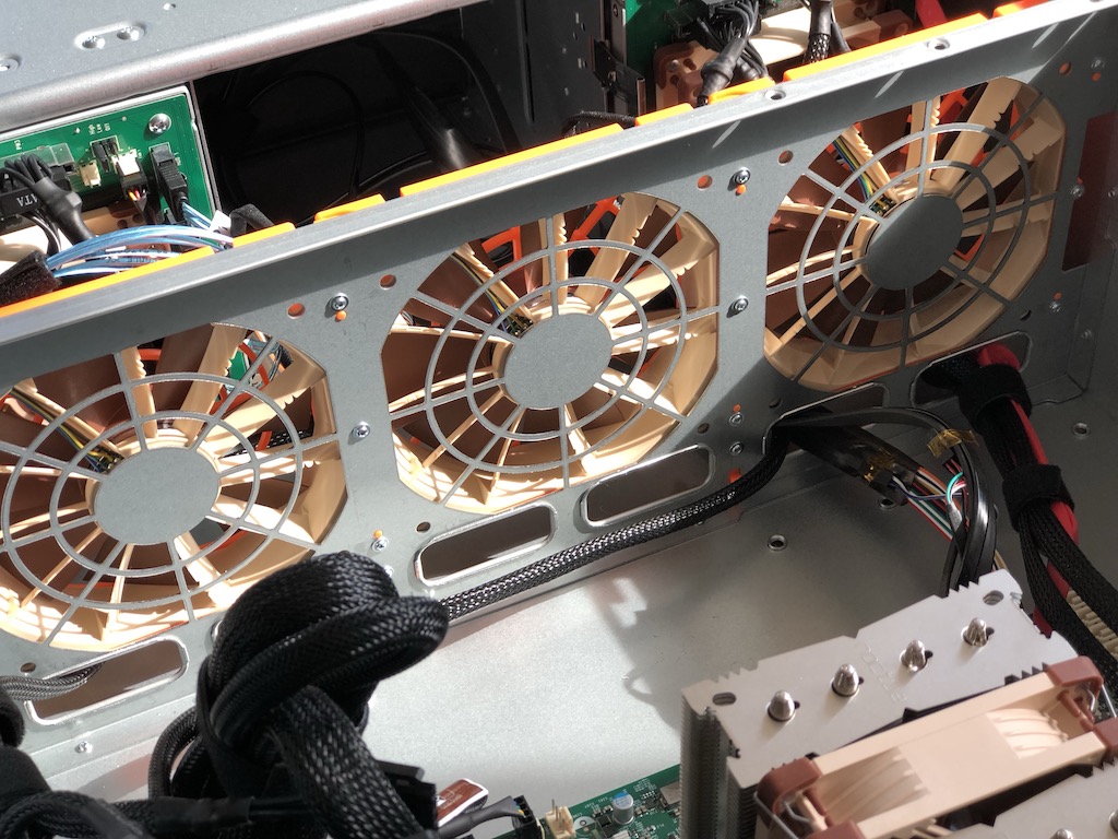

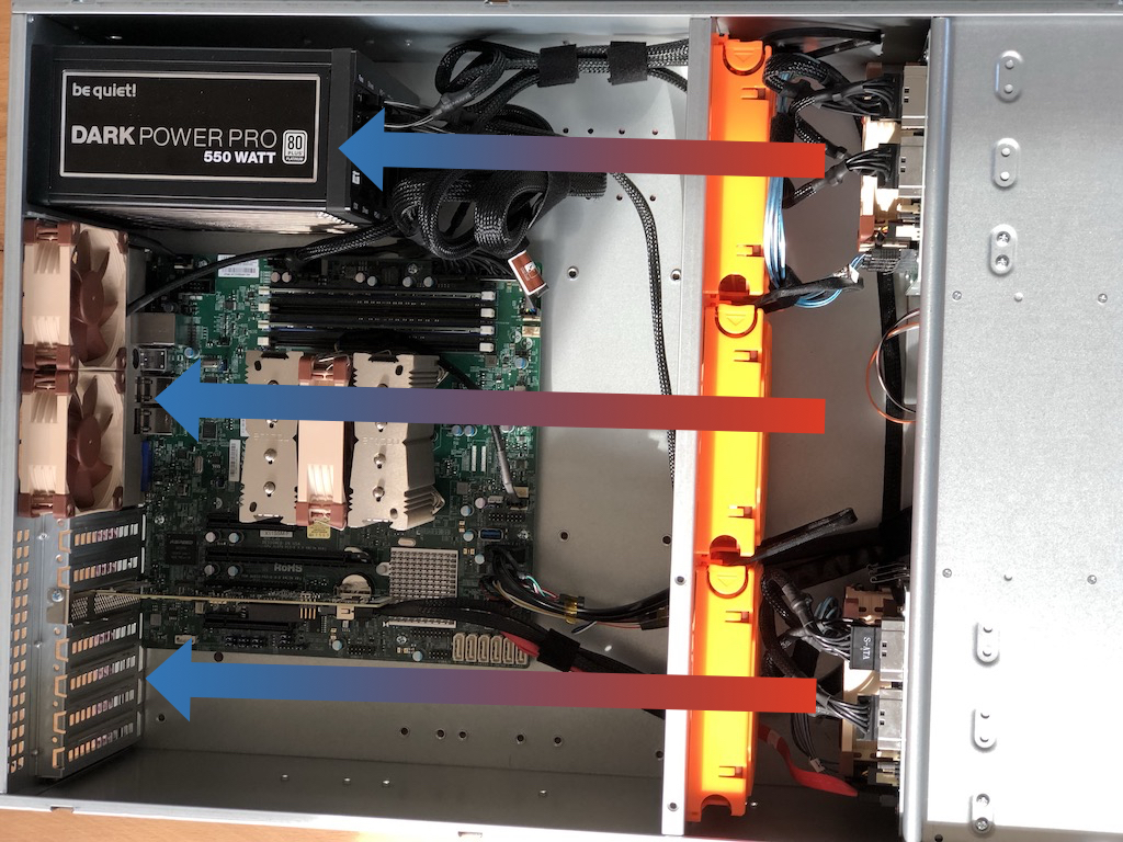

What I really love about this build is that it's (thanks to Noctua fans) very very quiet compared to an enterprise server. You could definitely put it in quiet office space and it won't disturb you.
The three hot-swappable 120mm Noctua fans behind the backplane provide an excellent airflow as to be seen below:

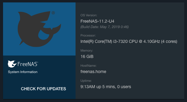

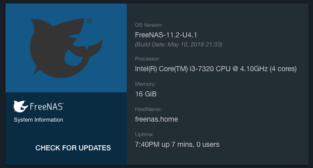

Just updated the machine to 11.2-U4. Reboot. Done. No problems. Very happy with this build it gets the job done :)

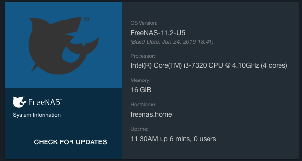

Quick update to 11.2-U5. Reboot. Done. No problems.

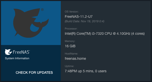

Quick update to 11.2-U7. Reboot. Done. No problems. Very nice!
