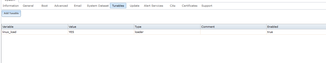

  1. Go to: System -> Tunables - Add Tunable
    • Variable: linux_load
      Value: YES
      Type: rc.conf
      Enabled: yes
  2. Manually load via: kldload linux
    • Upon Reboot, it will be auto loaded.
      Value: YES
      Type: Loader
      Enabled: yes
  2. Reboot
Thanks i will try that.

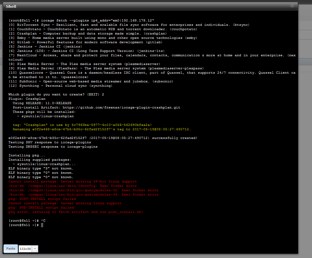

EDIT: Still get the error :(

Variable: linux_enable
Value: YES
Type: rc.conf
Comment: Load Linux compatibility module
Enabled: Ticked
I found this on an other place .... this works!
