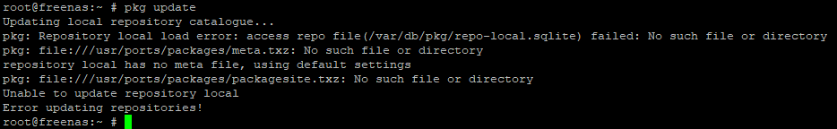

Meya
Dec 5, 2018
39
You could try plucking out the offending certificate from there to see if it fixes it.
Hello jgreco, my ca-root-nss.crt file has 151 certificates. How do I know which one is the offending one? I currently get this:
