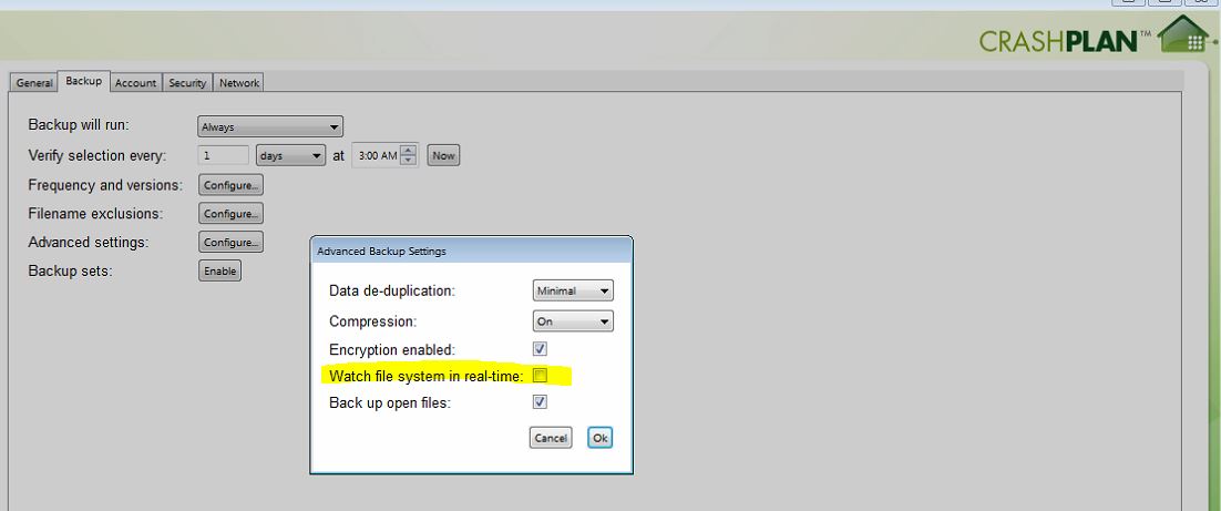

Mar 28, 2014
11
Yes, I've found that in my searching.
Also, I just found a setting in crashplan that turns on/off "Watch file system in real time". It was on, so I turned it off. Perhaps this function is using the inotify to trigger a backup when a file changes.
I'll update if in a day or two whether I'm still getting the messages.
Thanks
anodos
Sambassador
Mar 6, 2014
9,553
Thanks
I don't know if this is related, but there was a bug in samba/libinotify integration that was causing smbd to use 100% CPU. The workaround was to set "kernel change notify=no" in the smb4.conf file. On cursory review the parameter appears to now be the default. This means that crashplan probably wouldn't be able to track changes in real time in CIFS shares regardless of whether you check that box.
Toddebner
Mar 28, 2014
11
Still get the message no matter what I do.
Is there a way to stop the warning message ?
