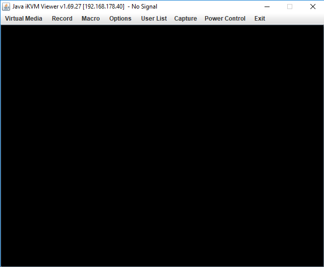

If you are in the WebGUI open the KVM Console. You can find it here: Remote Control -->> Console Redirection. It is a Java app. Ignore the warnings that it needs to be updated. Just open the offered java applet that will be downloaded to your browser.
Within the console you will find the Power Control menu. You can start, stop, reboot etc. The console shows the same thing as would be shown on a monitor during boot etc. In he KVBM console start or reboot the machine from the power control menu. You should see the boot strap etc. in the console window. If the console window stays black there might be something wrong with the motherboard.

After starting the applet the screen stays black and the title says "No Signal" (screenshot attached).
After shutting down and starting back up using the Power Control menu the system seems to get stuck in some kind of loop.
Speaker clicks once, fan stops spinning, ~5 second pause, speaker clicks twice, fan starts spinning, ~7 seconds pause and it stops again.
