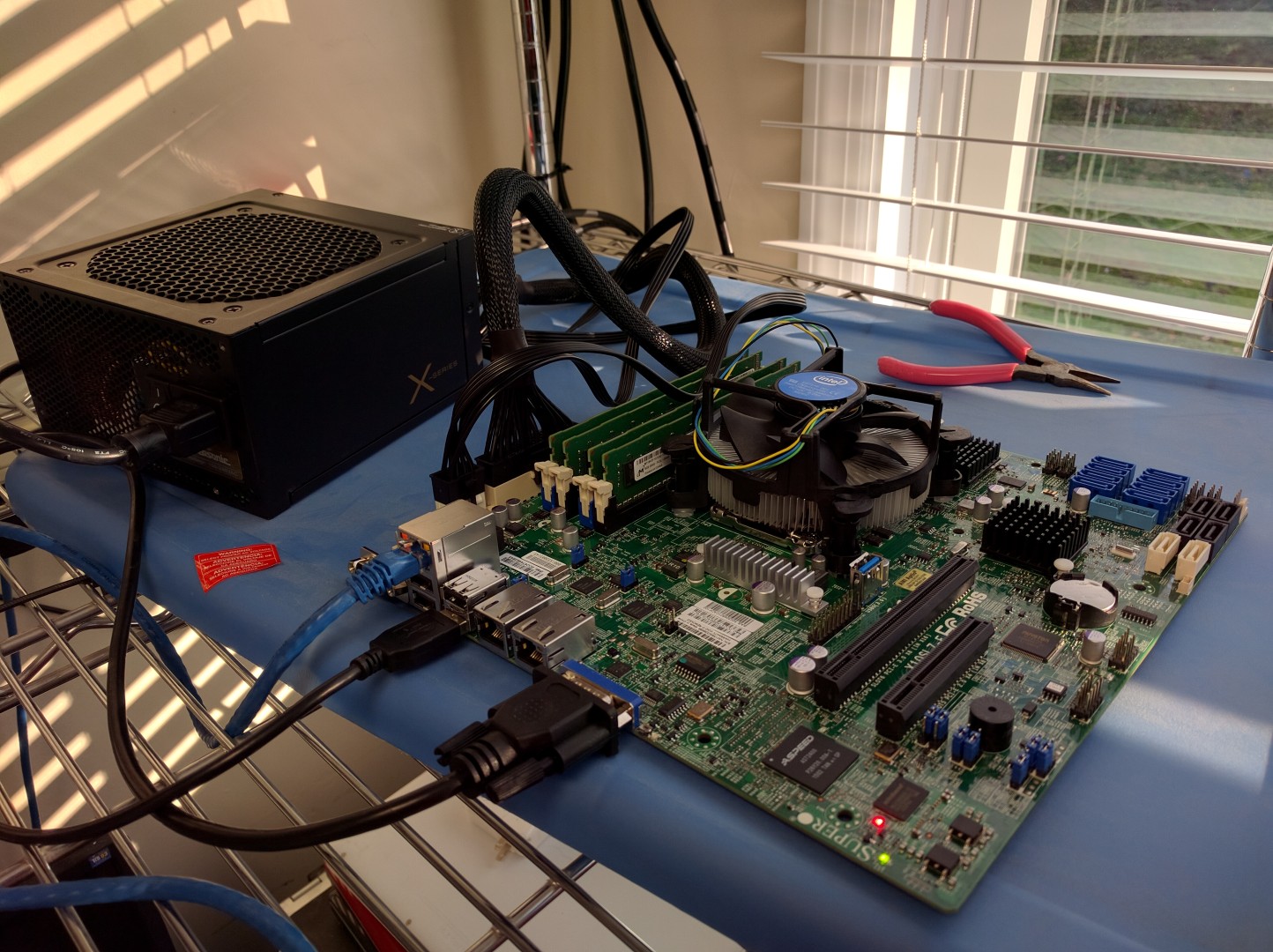

I popped it out of the case, put it on a plastic lid I have sitting around. Just Mobo, Ram, CPU & PSU. I jump the power:
PSU 1 (seasonic) - Power plugged in, not turned on - LED amber - jump power - LED goes red, unit powers on, fan starts turns on for 5 seconds, shuts off for 5 seconds, turns on for 5 seconds, rinse/repeat.
PSU 2 (brandx) - Power plugged in, not turned on - LED amber - jump power - LED goes red, nothing happens at all.
Guess the board is dead?
I am using the stock Xeon fan for the unit which just pushes on - could the CPU be heating up and shutting the board down?

Can you explain what "jump power" is please? because if you put a jumper on the power switch pin header it's maybe why you have this problem, it should be only a momentary connection.
Can't be the CPU overheating, the cycling is way too fast.
