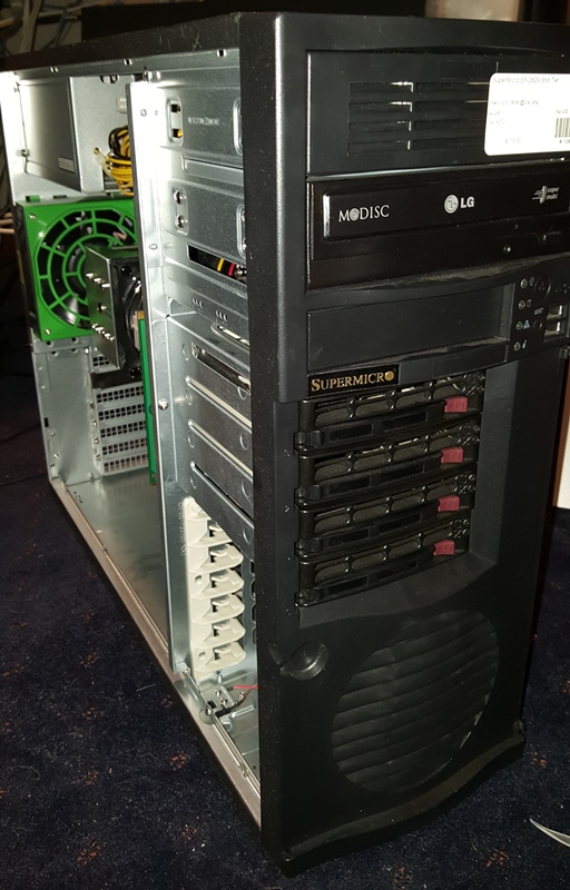

I found this server at a recycle store for about $175
I cant seem to identify the case but here is a picture
