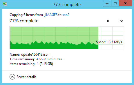

Again, didn't measure throughput before, but now: I'm getting 10-20M Bytes per second xfer speeds when transfering some 2GB .iso files from one drive to another within the same server, one virtual disk to the other, both residing on the same zvol. Now, just now when I tested it, it started around 150MBs, but within a few seconds went down to 10-20. Shot backup up towards the end.

So, wanted to update this post with some more info.
Here's a graph a transferring some files inside of a VM from one virtual drive to another, both drives sitting on the same 3.5TB zvol:

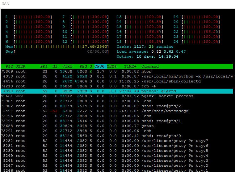

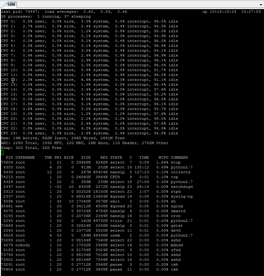

Here's what top -P shows:
But here's htop (isn't the high cpu strange? with no processes to justify it?):
So is there something the CPU is doing that FreeNAS isn't seeing that is using up CPU and causing this performance drop? Note what FreeNAS see as far as CPU (not much):
