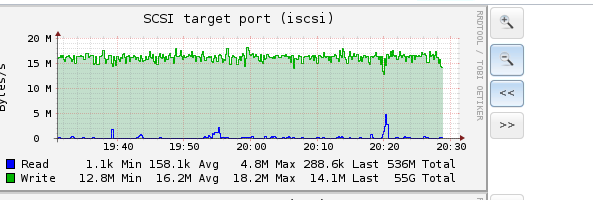

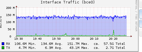

The problem as we speak is the very low performance. We run about 20 VM's MAX simultaneous . These virtual machines are very slow to respond , also for boot etc . Is there some way to see in freenas the latency of the storage ? Or the total IOPS of the system ? In reporting i can see in CPU about 15-20% MAX average , Memory is wired 58.9 G . Strange is the network traffic graph which is all time maxed at 150MBit so i thing something going on there . It is like it cannot go higher and it tops there.

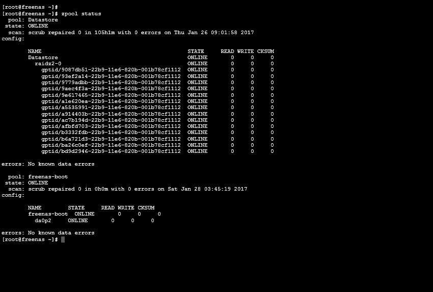

What is your pool layout?

Because i didn't create the pool layout , can you tell me where i can find this information ?

14 drive z2. Damn. That is far outside the recommendations even for a bulk storage server.
That pool would have the random IOP performance of a single drive.
Which is what you're seeing I think.
For a VM work load it's recommended to use mirrors rather than raidz.
Thus you would have a zpool consisting of 7 vdevs each vdev consisting of 2 drives.
This would improve the IOP performance 7 fold over your current system, but young from 12 disks for data to only 7.
Additionally for VM workloads it's recommended to keep the storage used capacity below 50%
