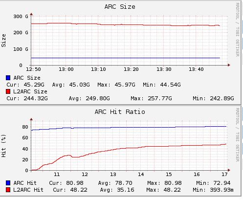

You are definitely good for L2arc, i'm running a 400gb l2 arc with 64 gb of ram and it works great! I am planning for another 64gb of ram as it will only make things better.

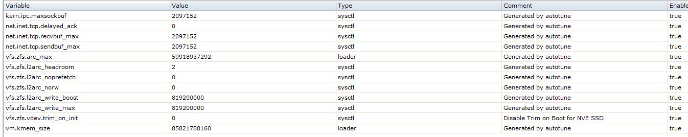

I attached my tunables.
When I build my next san, I would run 256gb of ram, a 400gb Intel 750nve for Slog and a 1.2TB Intel 750 for my L2Arc.
I've been checking my stats daily and my l2arc hits keep going up daily. about 1% increase per day lately. so it will be interesting to see if I hit over 50% later this week.
I should mention right now I only have 64gb of ram but it work really well!

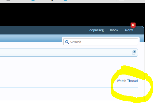

depasseg
FreeNAS Replicant
Sep 16, 2014
2,874
