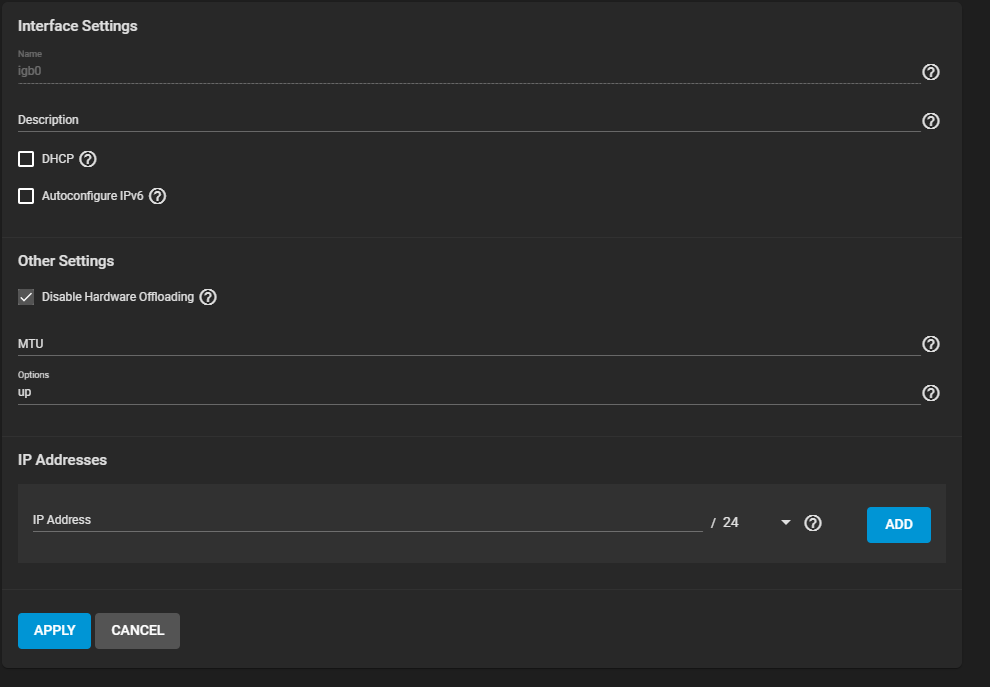

I should also explicitly say that when using the i350, I set all the jail's vnet default interface to IGB3, the port of the nic that has the ethernet connected.
Patrick M. Hausen
Nov 25, 2013
7,776

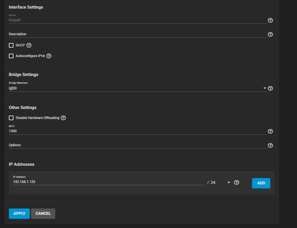

That looks good. You should move the IP address configuration from igb3 to bridge0 as documented in the FreeBSD handbook. If you don't have a bridge0 interface configured but have it autocreated by the jail subsystem, you need to remove it first by
  • disabling autostart for all jails
  • rebooting
Then you can follow these steps:
  • remove the IP address from igb3
  • disable hardware offloading for igb3 - important!
  • create a bridge interface, name bridge0, assign IP address to that, configure igb3 as member
  • change vnet_default_interface to "none" for all jails and make sure to set vnet0:bridge0 down in the network options
Your jails should run stable, then.

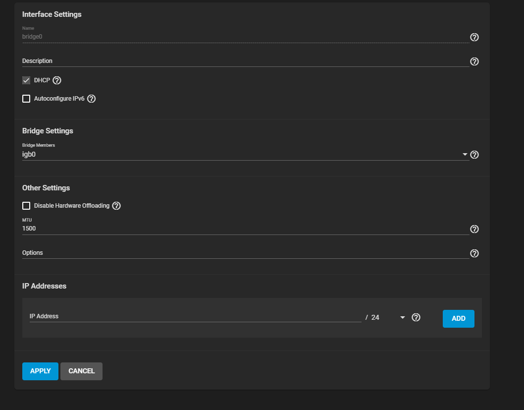

So when configuring the interfaces, I disabled DHCP and remove the IP address from IGB3. I then created a bridge with the ip address 192.168.1.133. Upon rebooting, I cannot access the web gui. I tried plugging the ethernet cable to different ports, re-enabiling re0, but nothing seems be assigned to any of the ports because none of them have DHCP enabled.
Patrick M. Hausen
Nov 25, 2013
7,776
You can activate DHCP on the bridge interface. Just make sure to have igb3 as a member, otherwise the bridge will not have a connection to your LAN. And disable hardware offloading (I am repeating myself) on igb3.
I did not get from your output that you were using DHCP. I would not recommend that for a server.

So i disable DHCP for IGB3, ensure hardware offloading is disable (truenas loves to warn me about this), then create a bridge1, add IGB3 and set the ip to 192.168.1.133.
Everytime I do this and reboot, I lose access to the truenas gui.

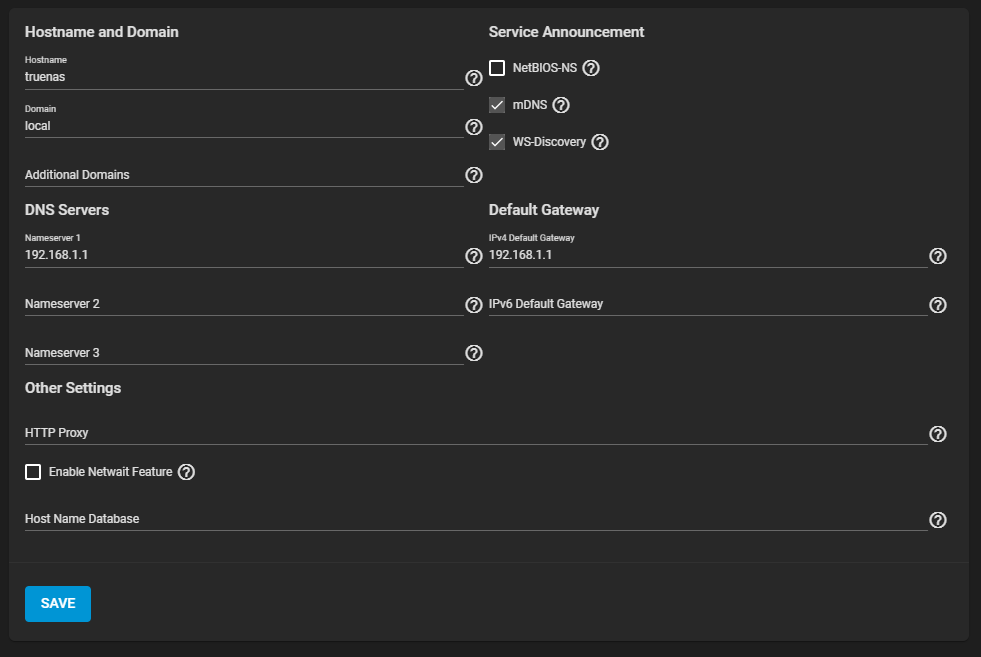

Here the thing though, I can ping the truenas box from my pfsense box at 192.168.1.133. Now the entire truenas gui is exhibiting the same issues as the jails.
Patrick M. Hausen
Nov 25, 2013
7,776
Is there a router between your desktop and the TrueNAS? In that case you need to set the default gateway in Network --> Global Settings. Or stick to DHCP, which you can use with the bridge just the same.

You need to remove the DHCP setting from igb0. You cannot have two interfaces (igb0 and bridge0) with different addresses in the same network.
The rest looks OK. How do the jails get their IP addresses?
Edit: just to make sure - please put "up" into the "Options" field of igb0. There were versions of FreeNAS/TrueNAS that did not automatically enable bridge members without an IP address.

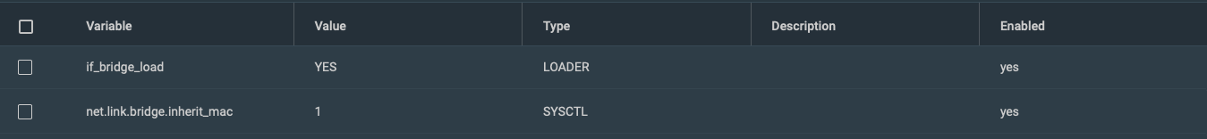

To get the bridge interface more stable in terms of ARP (mapping of IP address to MAC address) you can force it to inherit the MAC address from the first member interface. For that you need these two tunables:
For copy & paste:
if_bridge_load
net.link.bridge.inherit_mac
