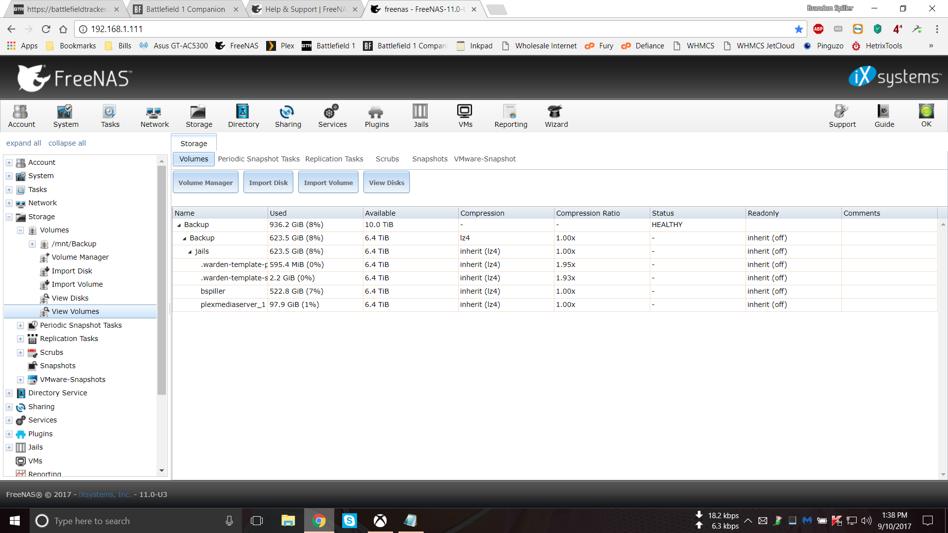

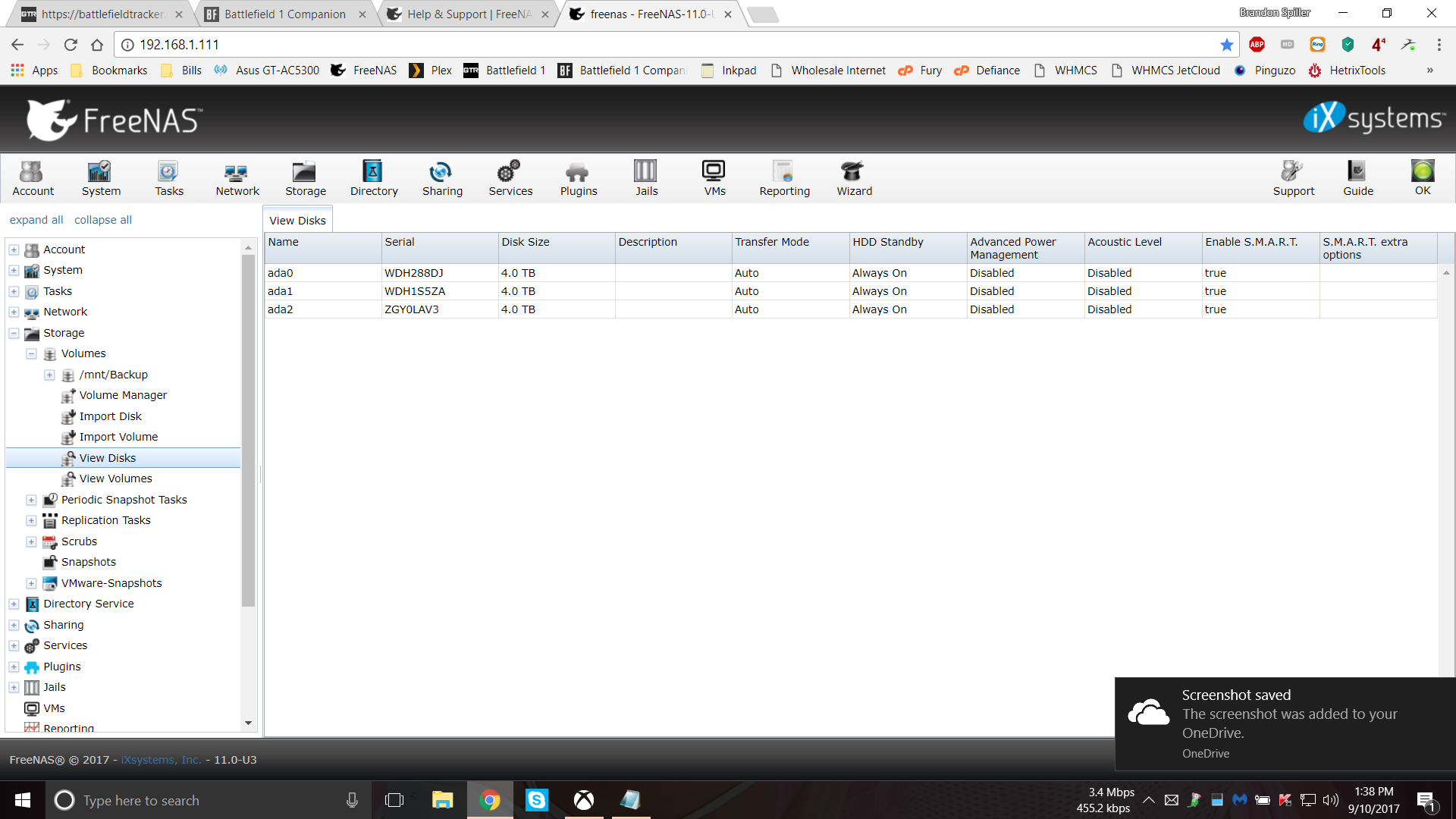

I have 2 FreeNAS servers. This one is my 2nd server. It has 3 x Seagate 4TB BarraCuda SATA 6Gb/s 64MB Cache 3.5-Inch Internal Hard Drive (ST4000DM005). When I click on the Storage it says 10 TB but it's only showing 6.4 TB available for use. I'm confused to where the 3.5TB has gone?

This is due to how FreeNAS and the ZFS file system do things, what is being shown on the first line is the raw disk storage. If you add up what is shown on the first line as used and available you will get the total RAW disk storage space in TiB.
Everything below that point is the pool space available for your actualy use. You are using a RaidZ1 so you lose one disk for redundancy so that is the actual space available for YOU as the end user to use.
Basically nothing is wrong and your system is working as intended.
