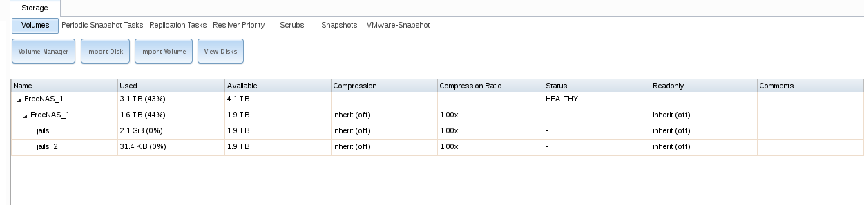

Hello!
I'm using FreeNAS 11.1
I've just changed the 4x WD Green 2TB drives in my FreeNAS for 4x WD Red 4TB drives..
I did this by replacing each drive at a time, over the past 2 days, by using a 5th drive slot on the computer (HP microserver), and followed the instructions in the guide from the GUI.
This says that at the end of the process, I should see the extra storage available under the Storage-Volumes tag.
I can see that the storage has increased to 7.2TB from 3.5Tb, but the size of the pool is still the same, at 3.5 TB.
Was I wrong to expect the pool size to increase? Or ... If I want a larger pool, should I destroy what I have, and recreate from the offline back-up?
Thanks for any advice!!
Alan
Please be more specific here. Describe exactly what you are seeing using which version of the GUI or show us a screenshot.
alanl
Dec 31, 2017
10
Please see the screen shot below..

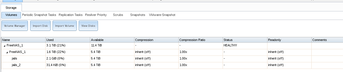

alanl
Dec 31, 2017
10
Many Thanks for the help..!!
I'm still a bit confused though...
In #13 above... it shows 11.4TB available, but on the next line down it shows 5.4TB available...?
Jailer
Not strong, but bad
Sep 12, 2014
4,977
First line is total disk space of the entire pool. Second line down is available disk space minus overhead and parity.
