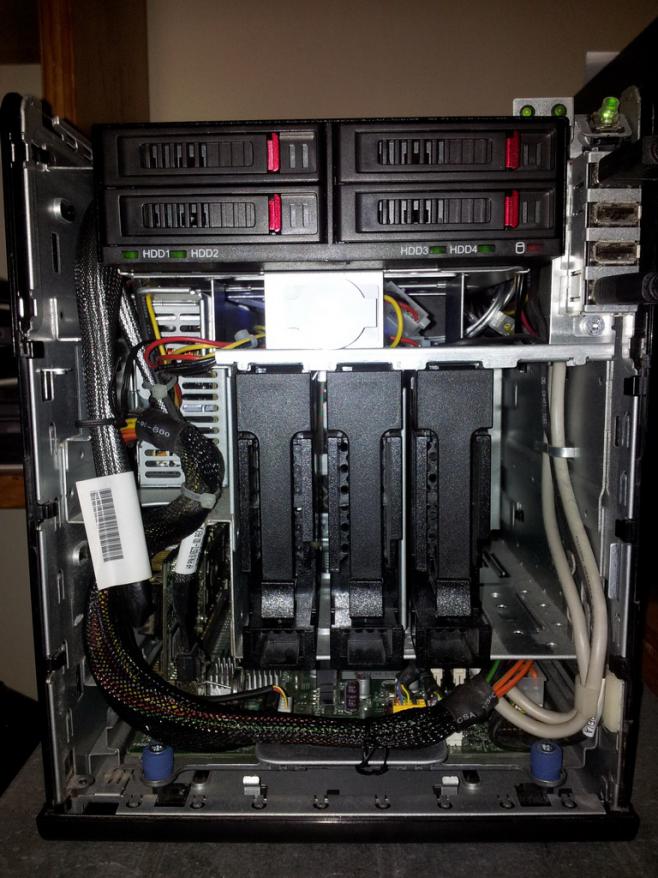

Hi guys,
I have build myself a NAS box. Have a HP Microserver with some mods to it. Freenas will be running of USB flash from internal USB.
The Microserver has the standard 4x 3.5" bays in the front, added a raid card to pci-e and a Vantec MRK-425ST EZ-Swap F4 Mobile Rack 4x 2.5" SATA6G in the 5.25" Rom bay, also have a cable running from the esata to internally for 1 more extra drive behind the Rom bay.
I am planning to add the following:
4x 3.5" SATA 2TB drives (3TB if i get them cheap) - in the front bays
4x 2.5" SATA 1TB drives in the Vantec EZ-Swap bays
1x 2.5" SATA 1TB (could be a 2TB also) behind the Vantec EZ-Swap bay
Now my question is how to configure the pool setup or manage the disks the best way? Anyone got some ideas?

Here she is, remember behind the Vantec EZ-Swap bay is place for one more 2.5" drive

Random thoughts for you to sort through.
Do please make sure you've got 8GB or more in that Microserver. (Yes I know HP says 8GB max, but 16GB works). This is mainly a frustration-prevention step for your benefit.
If you have a workable backup strategy, RAIDZ (which implies RAIDZ1) is perfectly reasonable to consider. Media streaming is not necessarily that intense (it may actually be one of the easier things for a NAS).
RAIDZ2 is generally slower than RAIDZ1. Striped will get you fastest of all, but of course no data redundancy, so any loss means restoring from backups, probably bad. However, RAIDZ1 in your case has one bad side effect: ZFS works best with certain numbers of drives.
RAIDZ1 vdevs should have 3, 5, or 9 drives in each vdev
RAIDZ2 vdevs should have 4, 6, or 10 drives in each vdev
RAIDZ3 vdevs should have 5, 7, or 11 drives in each vdev
You really need 5 devices to get "best" performance out of a RAIDZ1 vdev. Sucks, with all these 4-drive chassis systems, I know. So you could consider making one of your vdevs 5 devices, which you were already considering. That one will be faster than it would have been as a 4 device vdev.
If you combine the two vdevs in a single pool, tolerance for one lost drive in each vdev. Beware: two lost drives in a single vdev can render the whole pool useless. This might be a reason to consider two pools, but if you have backups, probably not.
