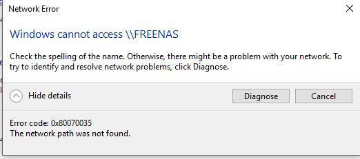

I'm on Version 1803 and the other System is on 1809.
It works perfectly on the 1809 Machine. I see a PC called "FreeNas" and i can connect to it.
It's at least showing up now on the 1803 Machine, but i get the "the networking path was not found" Error.

Please try to acces the SMB share using the IP adress assigned to Freenas. I it's working you can edit your hosts file in Windows.
