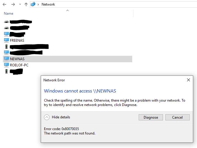

I've set up my first FreeNAS system a while back. I mounted an SMB share on my windows machine. All good so far.
Now I'm setting up my second box alongside the first, and trying to mount it in Windows. I need to manually transfer some files from the first to the second box.
The following regards the second box:
I am able to reach the web-GUI. However, in Windows, I can see the share through network discovery, but trying to access it gives the following error:
"Windows cannot access
\\NEWNAS Error code: 0x80070035
The network path was not found."
I've tried accessing it manually in the top bar through \\192.168.2.220 this gives an "Unspecified error" 0x80004005.
I didn't find anything useful on Google, but I'm probably missing something...
The second (new) box has a different (static) IPv4 address, so no conflict there (I think). I've also renamed the Hostname (under Network/Global Configuration) to something different (newnas, instead of freenas).
I've had some trouble with out-of-sync clocks on my systems, but Date in the console appears to give the same time, and both NAS systems use the same NTP servers.
Both SMB services are set up identically, as far as I can tell, except for the NetBIOS Name and BindIP Addresses (newnas and 192.168.2.220 respectively).
The Samba Shares on both machines are set up similarly.
Any help would be appreciated, even if it's a nudge in the right direction. What am I doing wrong here?
Thank you for reading.

Forgot to mention: both NAS systems are running FreeNAS-11.2-U7 and the client is running Windows 10 Education
Dec 11, 2019
6
I think I solved it. By going to run in Windows (win + R) and trying to enter \\192.168.2.220 I got a different error. I found this video on youtube explaining how you can Enable insecure guest logons in Windows. Now running \\192.168.2.220 again I successfully accessed the share.
