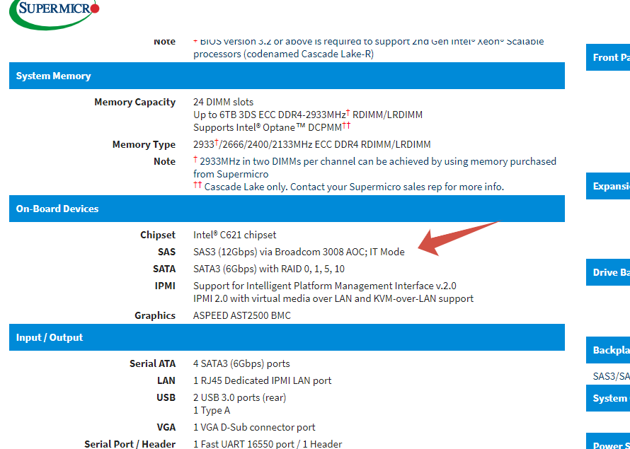

it mode on the controller is already from the manufacturer. in

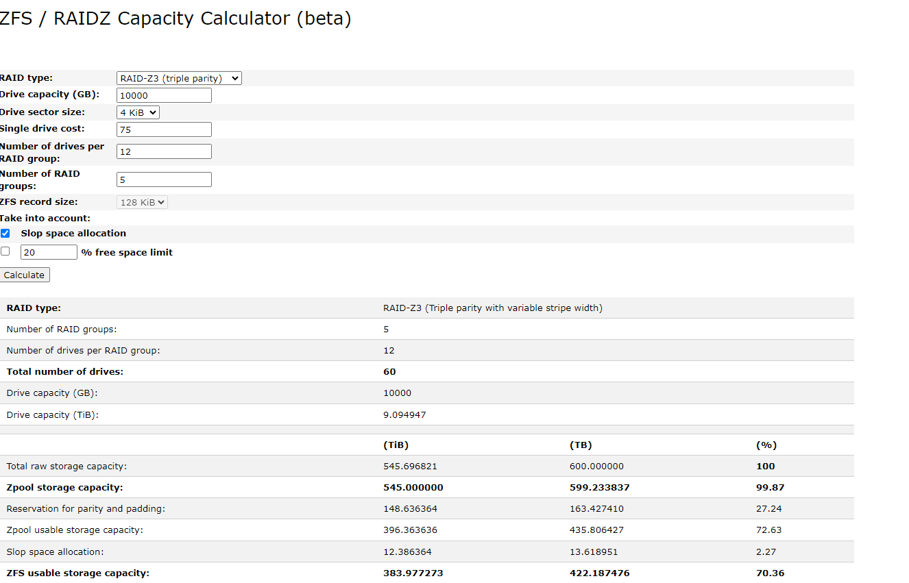

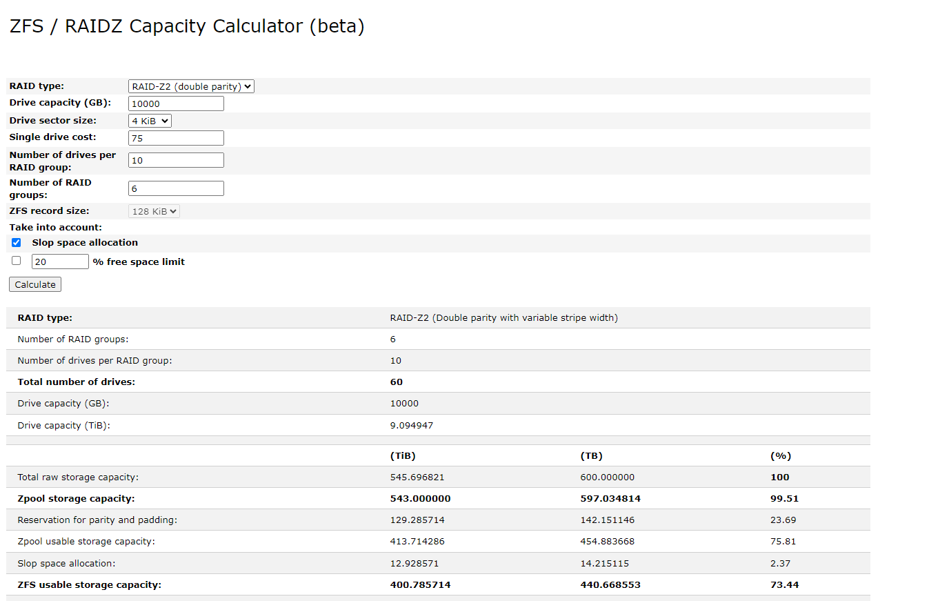

By volume it turns out: I didn't change the cost of the disk on the calculator, the disks are already in stock, 10 TB each):
Как я понимаю будет 383-400-414 Тб максимум при использовании zfs
6x 10d raidz2
(Tb) (TB) (%)
Total raw storage capacity: 545.696821 600.000000 100
Zpool storage capacity: 543.000000 597.034814 99.51
Reservation for parity and padding: 129.285714 142.151146 23.69
Zpool usable storage capacity: 413.714286 454.883668 75.81
ZFS usable storage capacity: 400.785714 440.668553 73.44
5x 12d raidz3
((Tb) (TB) (%)
Zpool storage capacity: 545.000000 599.233837 99.87
Reservation for parity and padding: 148.636364 163.427410 27.24
Zpool usable storage capacity: 396.363636 435.806427 72.63
ZFS usable storage capacity: 383.977273 422.187476 70.36

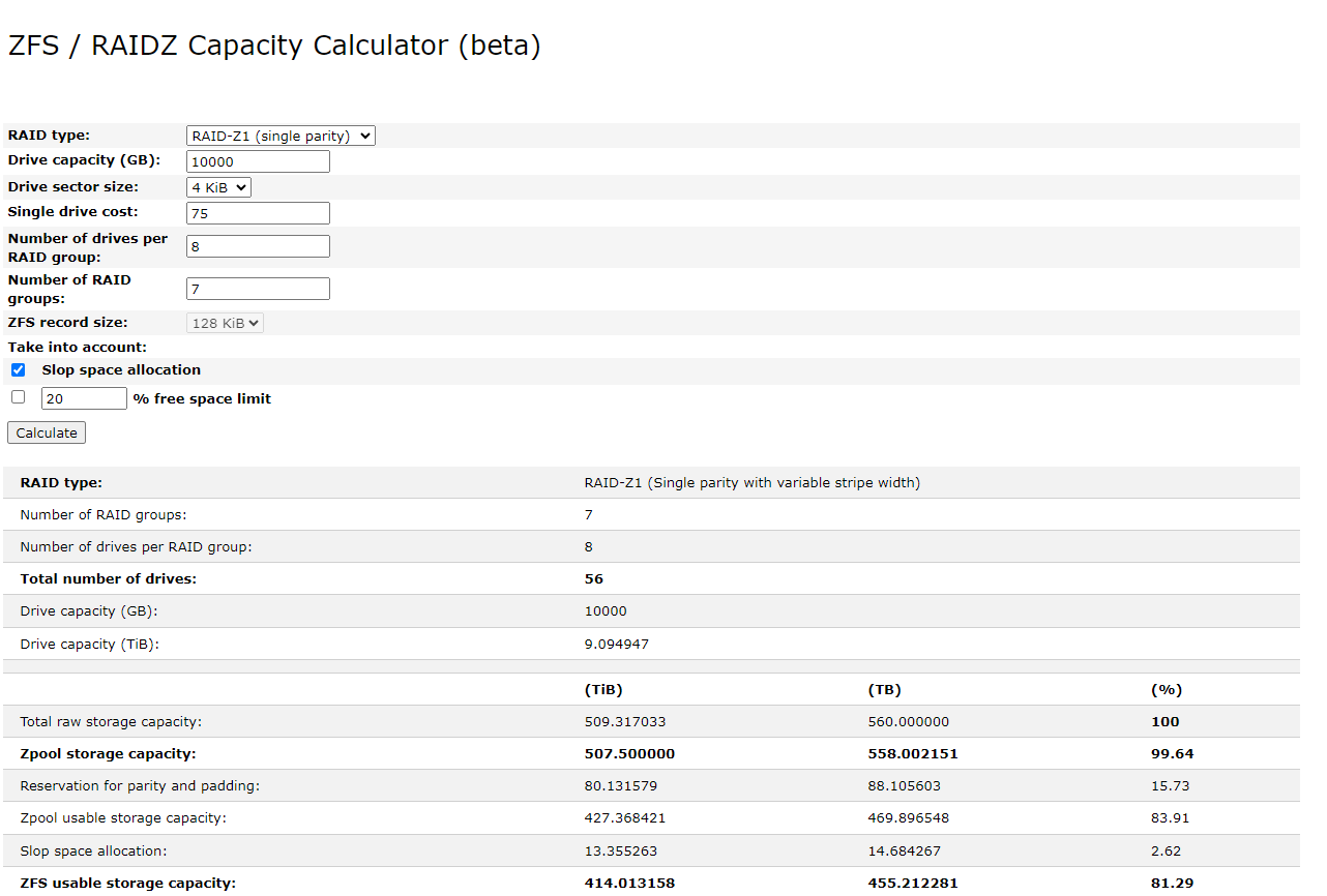

7x 8d raidz1 + 4 hot-spare
((Tb) (TB) (%)
Total raw storage capacity: 509.317033 560.000000 100
Zpool storage capacity: 507.500000 558.002151 99.64
Reservation for parity and padding: 80.131579 88.105603 15.73
Zpool usable storage capacity: 427.368421 469.896548 83.91
ZFS usable storage capacity: 414.013158 455.212281 81.29

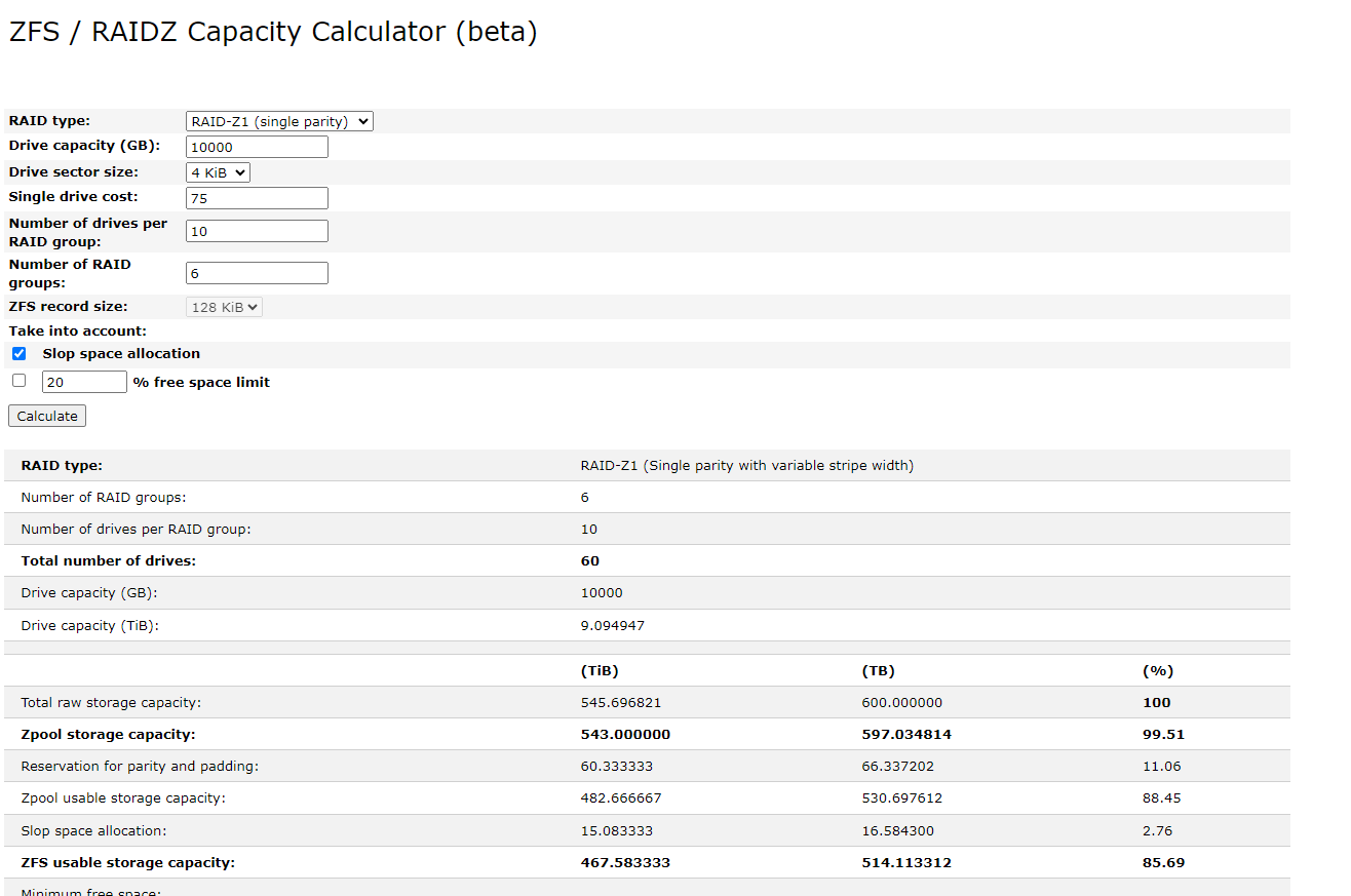

The largest in terms of volume seems to be obtained
6x 10d raidz1 - 514 Tb.
Failure of no more than 1 disk in the array and quick replacement by hand - without hot-spare.
Will something close turn out, but with a failure of up to 2 disks in the array or raidz1 + at least 2 hot-spare?
((Tb) (TB) (%)
Reservation for parity and padding: 60.333333 66.337202 11.06
Zpool usable storage capacity: 482.666667 530.697612 88.45
ZFS usable storage capacity: 467.583333 514.113312 85.69

I wouldn't go RAIDZ1: the second something unexpected happens, you lose your entire pool.
Use RAIDZ2 at the minimum since this is an enterprise-level system.
If you want max space with some degree of protection you could go with 5x RAIDZ2 VDEVs composed of 12 drives each. No hotspares though.
You should consider leaving at the very least 10% of the pool empty.
Patrick M. Hausen
Nov 25, 2013
7,776
I would never use RAIDZ1 with 10 TB drives. But you do you. I would be happy to have such a monster with 400 TB of usable space.
