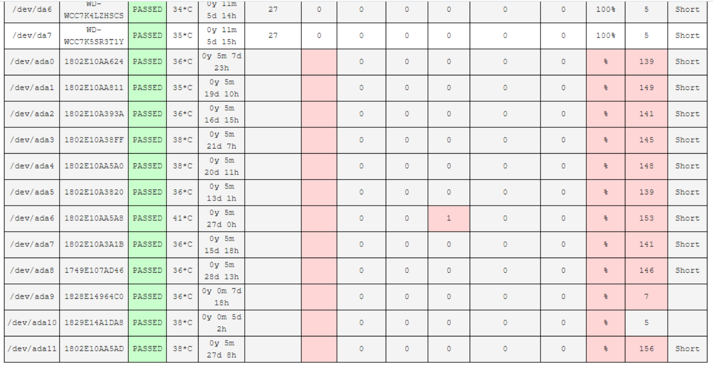

That looks a different issue, the MX500 keeps cycling between 0 and 1 pending sectors, for all drives, sometimes they show up on the daily report, for example this is the report from Tuesday:
You can see 1 pending sector for ada6 at the time the report was made, this is the report for Wednesday:

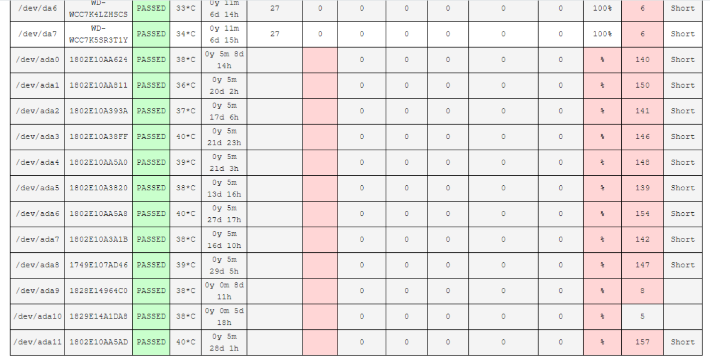

Pending sector gone, and it keeps cycling like this, for all the SSDs.
