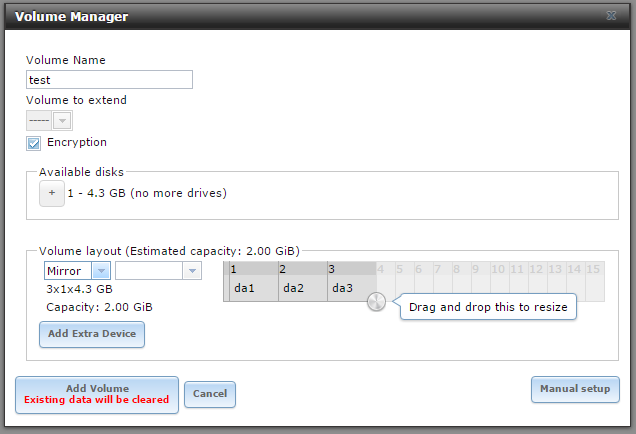

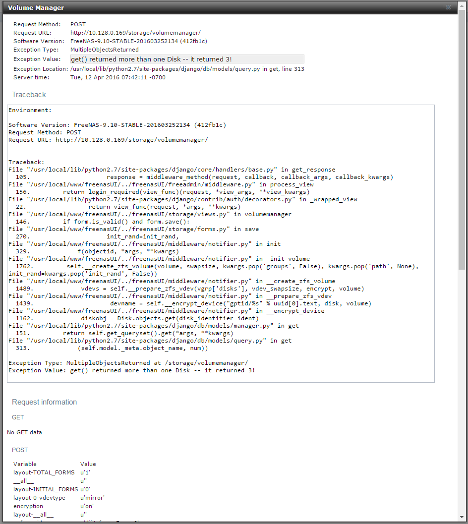

Another question.. how to create 3 way encrypted mirrors if the UI doesn't support 3 way mirrors?
cyberjock
Inactive Account
Mar 25, 2012
19,525
You should be able to do 3 way encrypted mirrors. I can't try it right now, but I'm 99% sure you can do it. Just drag the vdev to make it 3 disks wide, then choose mirrors.
David E
Nov 1, 2013
119
No dice unfortunately
https://bugs.freenas.org/issues/14599
