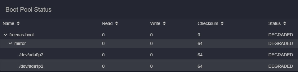

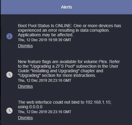

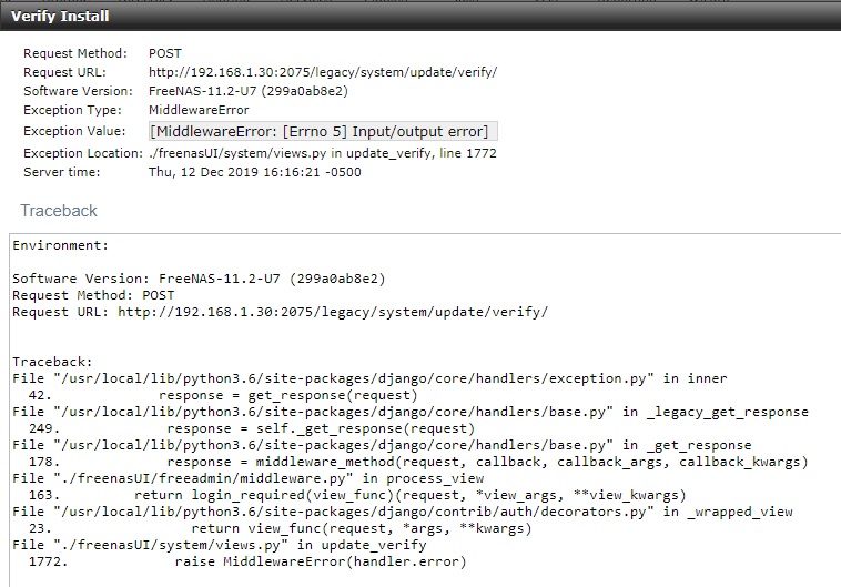

I had a 6 year old Sandisk flashdrive and it began to have issues loading FreeNas, so i made a new backup of my config file
and installed two identical SSD drives and reinstalled with the latest FreeNas and choose the option to install
using UEFI however it wouldn't boot to the drive after the install so i formated them and repeated the installation
and choose BIOS then uploaded my config file and all is great other than i'm getting the same error.
Since the drives are new and i had to repeat the install i'm thinking it was related to my install issues ?
Does that sound more likely than one of my new SSD drives are on their way out ?

We have seen, over the years, that certain brands and models of SSD do not work reliably with ZFS / FreeNAS.
Were the new SSDs the same brand / model as the six year old one? What model drive are we talking about here?
