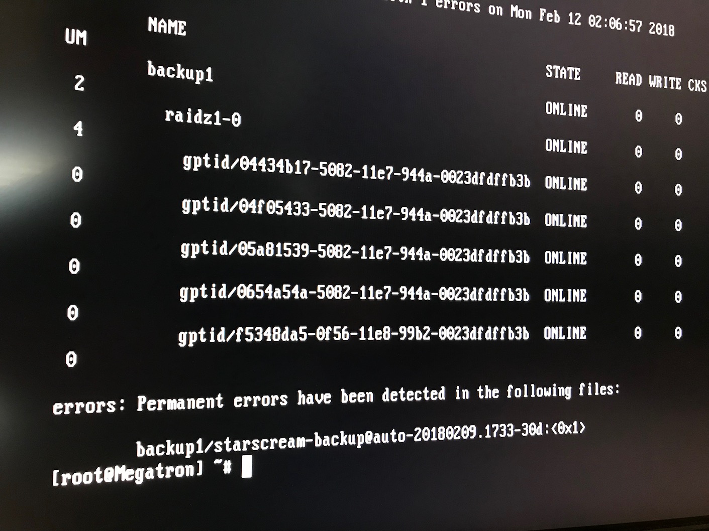

I was able to run the zpool status -v backup1 directly on the server itself, and there is one "file" corrupt:
It looks like a snapshot taken from a few days ago when all this started.
Does anyone know what my options are? Can I delete the snapshot in the GUI? What are the consequences of this?
Or can I resend that snapshot from my main pool to backup1?
Appreciate any help or advice.

I would say,
Delete the affected snapshot in the GUI (storage->snapshots->highlight the snapshot->delete).
Then, do a
zpool clear poolname
on the affected volume to clear the error,
Then, kick off a scrub immediately to verify you're alright:
zpool scrub poolname
and I believe "poolname" here is "backup1" if I'm reading your (literal) screenshot correctly.

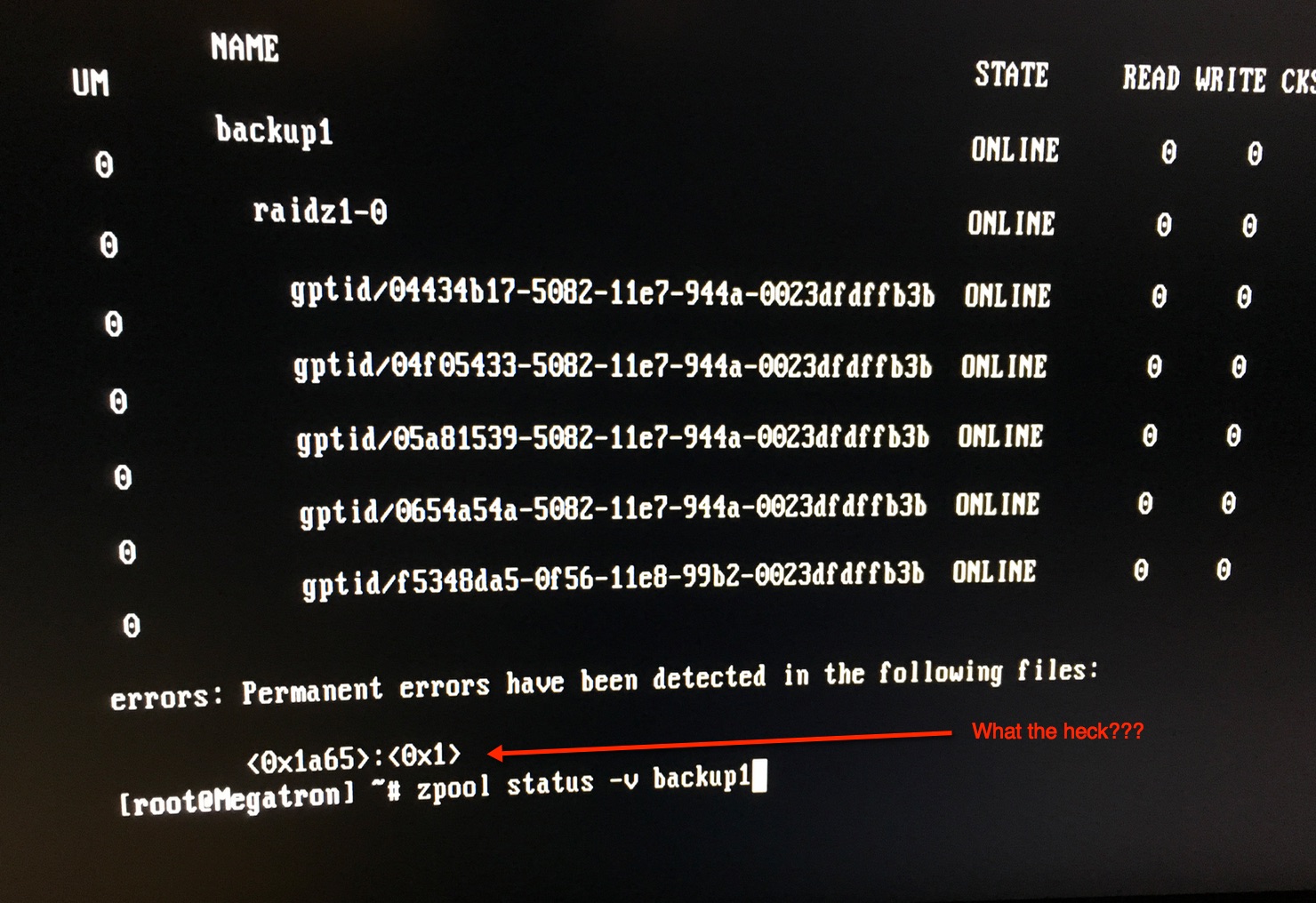

  1. I tried to clear the pool errors using zpool clear backup1 and zpool status still showed "1" error
  2. I deleted the corrupt snapshot
  3. I reran the scrub
  4. I performance another zpool status -v and now there's another snapshot of the same kind, just a different date, showing as corrupt.
  5. I deleted that snapshot, and ran zpool status -v, but now there's a strange "file" showing as the corrupt file:
Strange thing is, zpool status -v only reports 1 error / corrupt file, but when I delete that "file" (in my case, snapshot), it shows a different "file" next time I run the command. Now it's showing <0x1a65>:<0x1> as the corrupt error and I have no idea what to do next.
Any suggestions are greatly appreciated.

That error you have is a "metadata" error.
I don't know why you had non-correctable errors in the first place, if you are on a raid-z1, and you only had one drive go bonkers. You're supposed to be resilient to one drive offlining.
Do you have any insight on that? You should have been able to have corrected these errors fully without corrupted snapshots or whatever.
