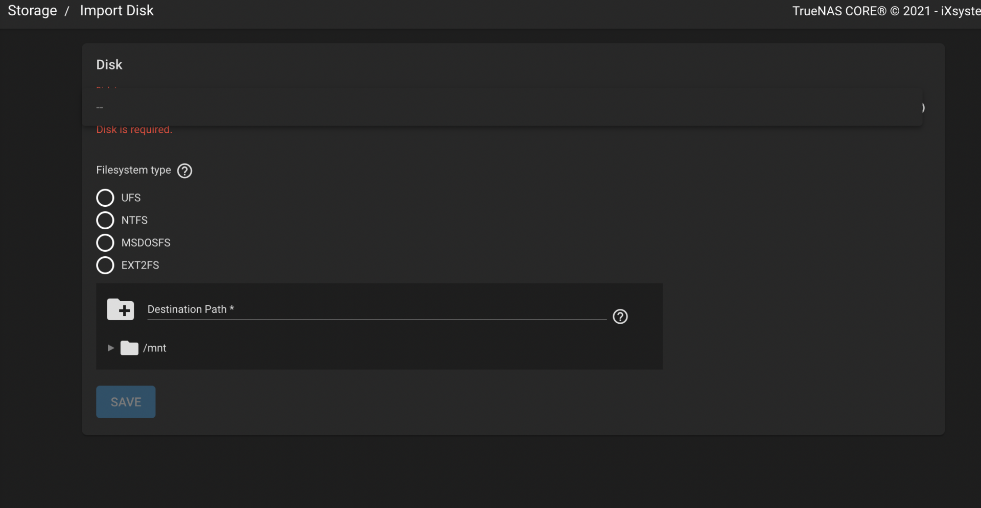

I don't get an option to Wipe the disk as i do with my others unfortunately.

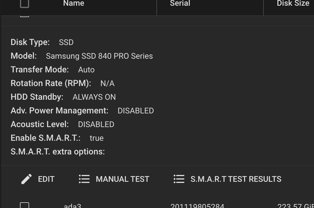

9,700
I can't see from that screenshot, but I think it's ada2, so (assuming that's correct) you can use:
