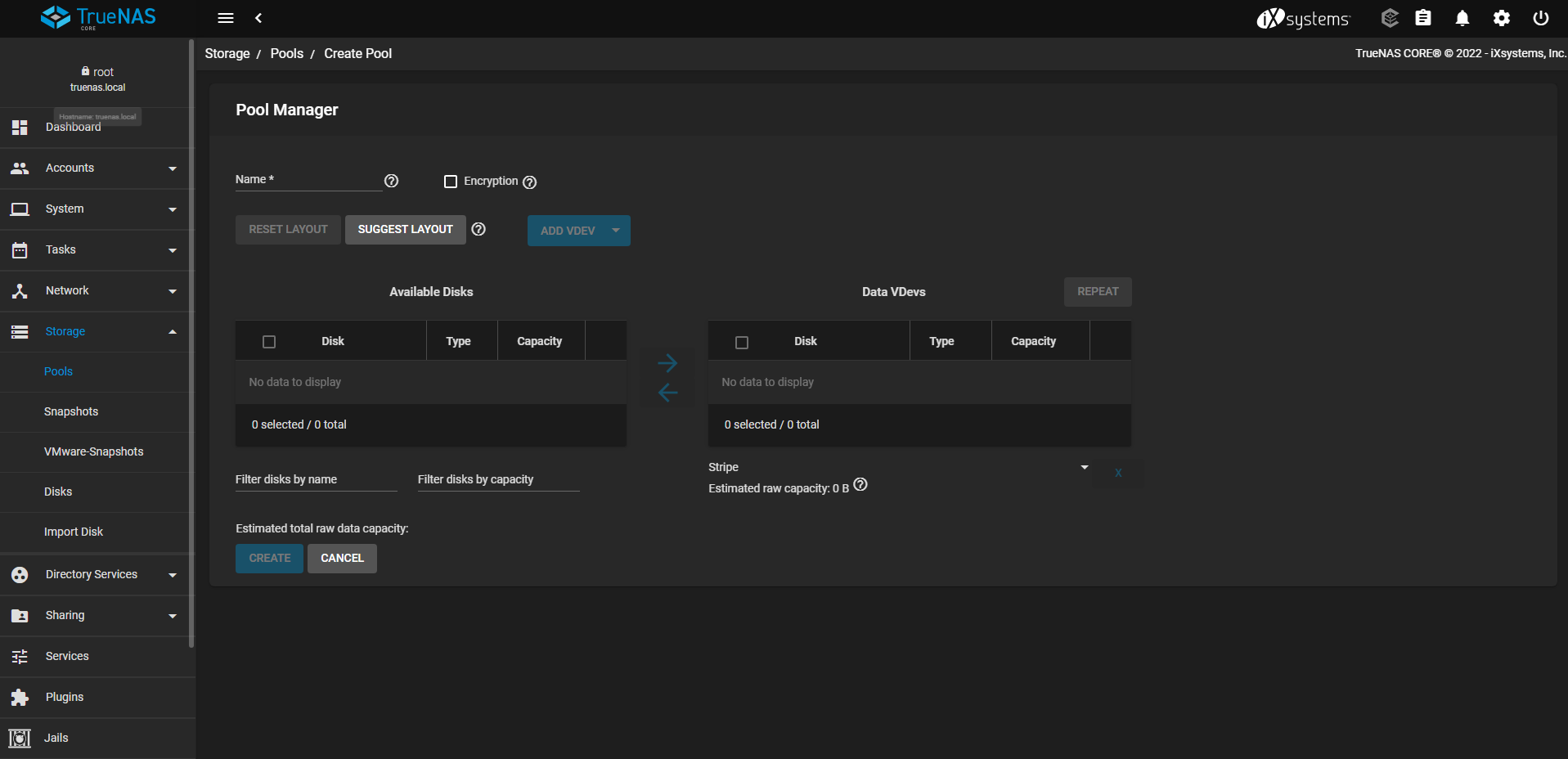

- Storage -> Pools -> Add -> Create new pool
I come to a point by following the path, but the disks or "Logical Vol" on the Raid Card do not appear in the "Available Disks" section.

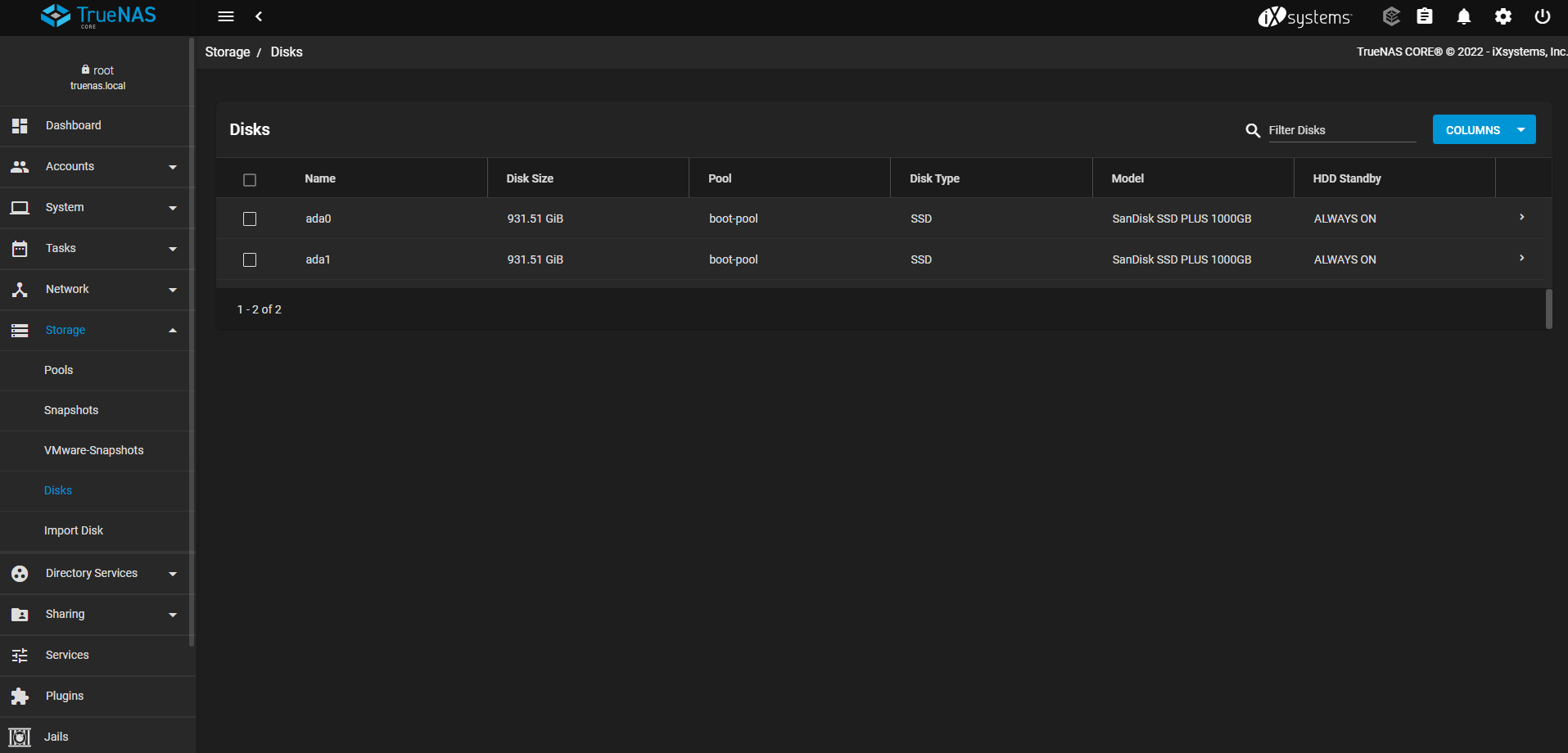

- Storage -> Disks
When I look at the partition, only operating system disks with SSDs with the names "ada0, ada1" appear.
(SSD disks are not connected to AVAGO 3108)

root@truenas[~]# camcontrol devlist
<SanDisk SSD PLUS 1000GB UH4504RL> at scbus4 target 0 lun 0 (ada0,pass0)
<SanDisk SSD PLUS 1000GB UH4504RL> at scbus5 target 0 lun 0 (ada1,pass1)
<AHCI SGPIO Enclosure 2.00 0001> at scbus6 target 0 lun 0 (ses0,pass2)
<AHCI SGPIO Enclosure 2.00 0001> at scbus15 target 0 lun 0 (ses1,pass3)
<SMC SC846-P 100b> at scbus17 target 0 lun 0 (ses2,pass4)
