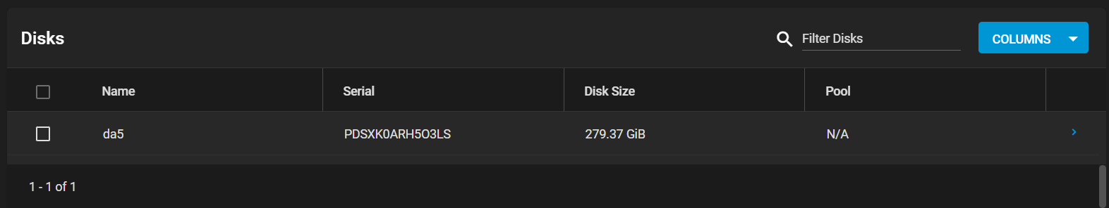

I have installed TrueNAS and have a problem with some disk did not shown on disk list.
From Storage > Disks only shown da5
here is my disk list:
root@truenas[~]# camcontrol devlist
<HP RAID 0 OK>                     at scbus0 target 0 lun 0 (pass0,da0)
<HP RAID 0 OK>                     at scbus0 target 1 lun 0 (pass1,da1)
<HP RAID 0 OK>                     at scbus0 target 2 lun 0 (pass2,da2)
<HP RAID 0 OK>                     at scbus0 target 3 lun 0 (pass3,da3)
<HP RAID 0 OK>                     at scbus0 target 4 lun 0 (pass4,da4)
<HP RAID 0 OK>                     at scbus0 target 5 lun 0 (pass5,da5)
<AHCI SGPIO Enclosure 2.00 0001>   at scbus9 target 0 lun 0 (ses0,pass6)
da0 and da1 used for boot-pool.
any suggestion for my case?
Thank you.

Do not use RAID.
if I'm not configure Array disk, when I'm installing TrueNAS it shows no disks.
it's HP server with smart array controller.
So replace your RAID controller with a proper HBA.

Im following this from docs:
If your RAID card does not have this mode, you can configure a RAID0 for every single disk in your system. While not the ideal setup, it works in a pinch.
my curious is why only one disk shown while the systems shows all the disks.
after installation I can see all the disks, but after a day became like this.
Whatever docs you're reading are speaking very generally, and lots of RAID cards are quite shitty and don't actually work if you try that. Read the article that you've been referred to several times. Get rid of the godforsaken RAID controller and replace it with an HBA.
