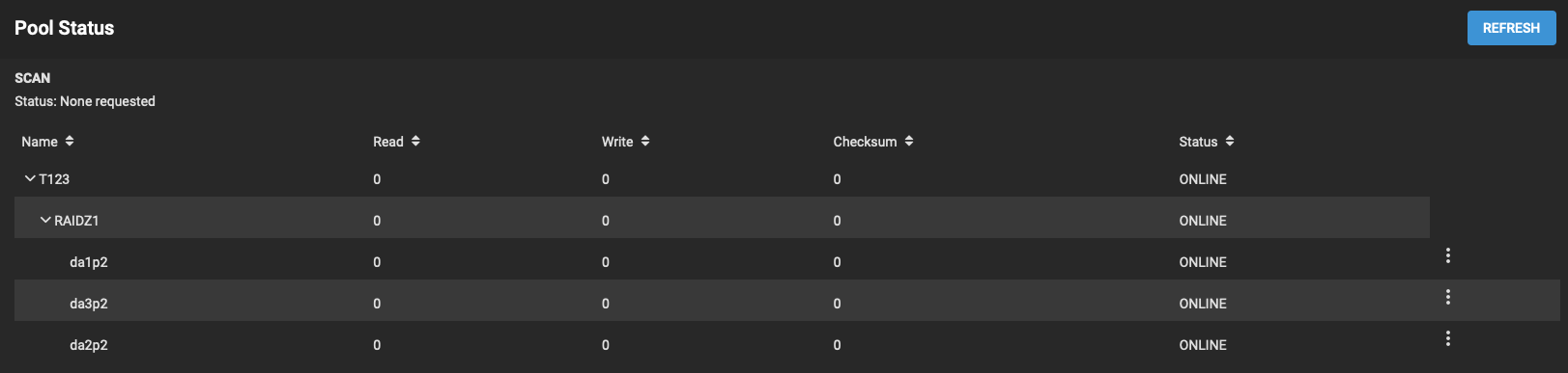

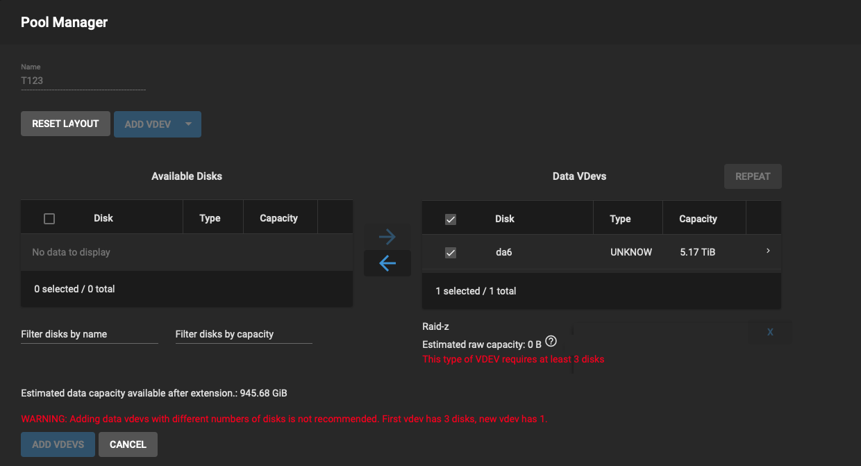

I am also trying to expand an existing pool but am running into an error. Any help would be appreciated.
Currently I have a pool of 3x 6TB hds and would like to add two more (2x 6TB hds) for a total of five(5), one at a time.
When I click settings/add vDev this is what I get.
ZFS doesn't work that way. You could add another group of three disks in a second RAIDZ1 set, but you can't (currently; it's Coming Soon™) expand the pool by a disk at a time.
videopete
Sep 5, 2021
14
Your redundancy is WITHIN the vdev not the overall pool itself. So your existing pool has a single 3 disk vdev configured as RAIDZ1 (one disk could fail and you're still ok). Your screenshots are showing you're trying to add another RAIDZ1 vdev which requires 3 disks minimum. That way each vdev would have a single disk redundancy and your pool would be safe as long as you don't lose more than one disk per vdev group.
