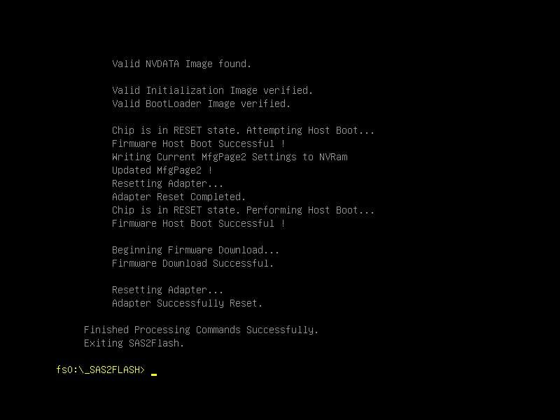

To give more detail on the issue I made some screenshots:
flashing the DELL FW provided in the package from the guide finishes fine

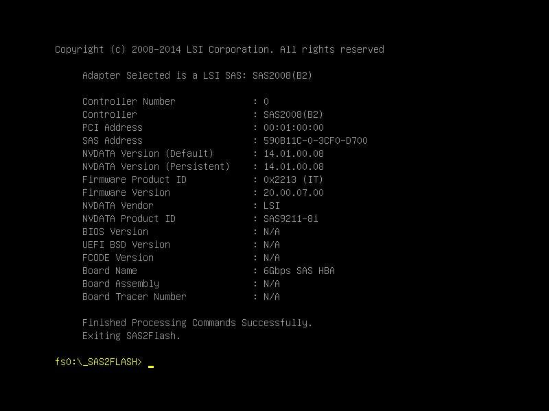

what bugs me is altough the provided firmware says it's IT-mode in the filename ("DELL-A10- 6GBPSAS-8e-IT.FW"), after flashing it still gives an "IR" after Firmware Product ID, see here:
according to the guide it should miss the "IR", to go on crossflash the LSI fw.

Ok, got it. This was the key advise, thanks to @Newfoundland.Republic
1) DELL IR -> DELL IT, 2) DELL IT -> LSI IT P7, 3) LSI P7 -> LSI LATEST (P20+)
I read that multiple times, but it seems I didn't understand it fully.
You have to start with a DELL IR FW. The one provided in the package under the newcomers thread is the "IT" FW, which comes into play in step 2.
Which means, even if your card comes shipped with IR FW you can't just skip step 1. That's what I didn't get.
I had to download the DELL IR FW from here: https://www.dell.com/support/home/de/de/debsdt1/drivers/driversdetails?driverid=8vgc6 even though it is A09.
From there it went as described in the guide.
