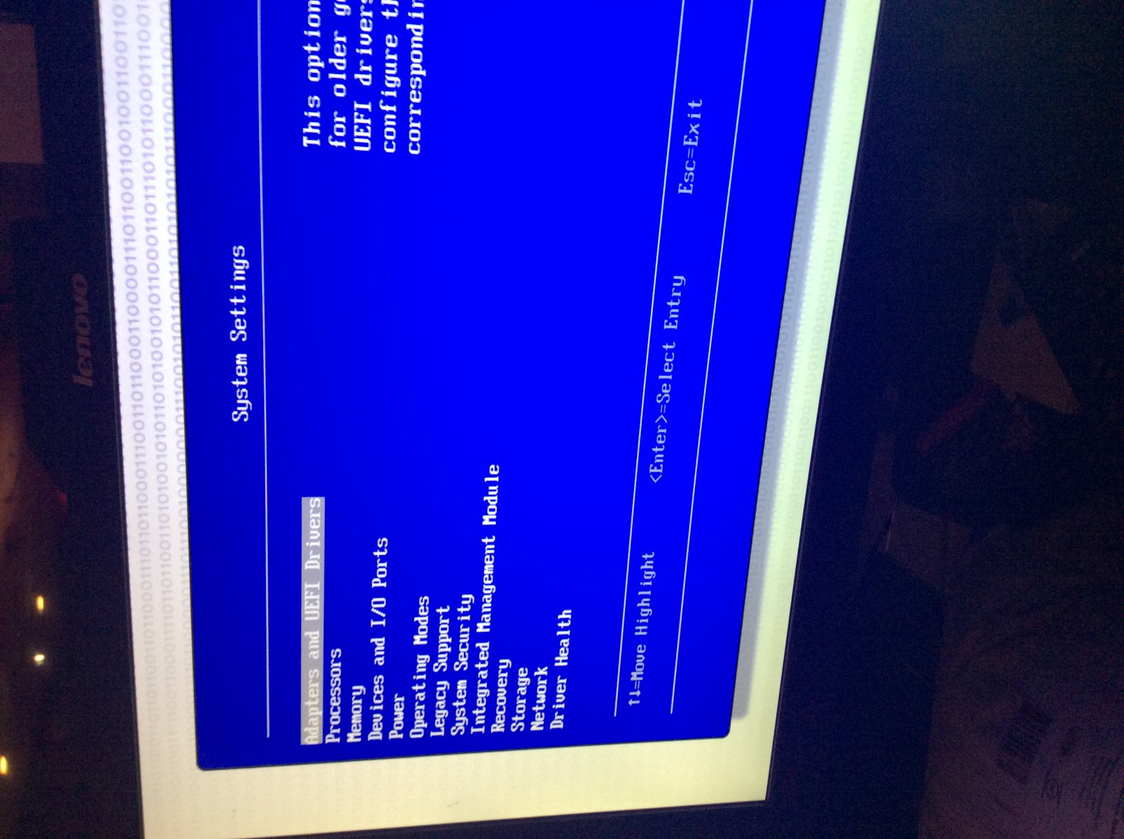

Here is a screen shot of the BIOS too...IP6 is disabled but nothing else looked off to me. Any suggested changes?
Thanks
Is this ipmi settings?
Typically your BIOS has nothing to do with the actual network configuration. That's left up to the OS

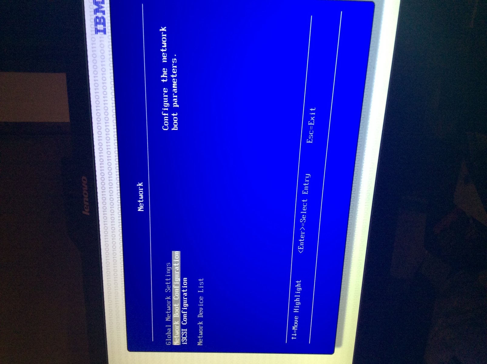

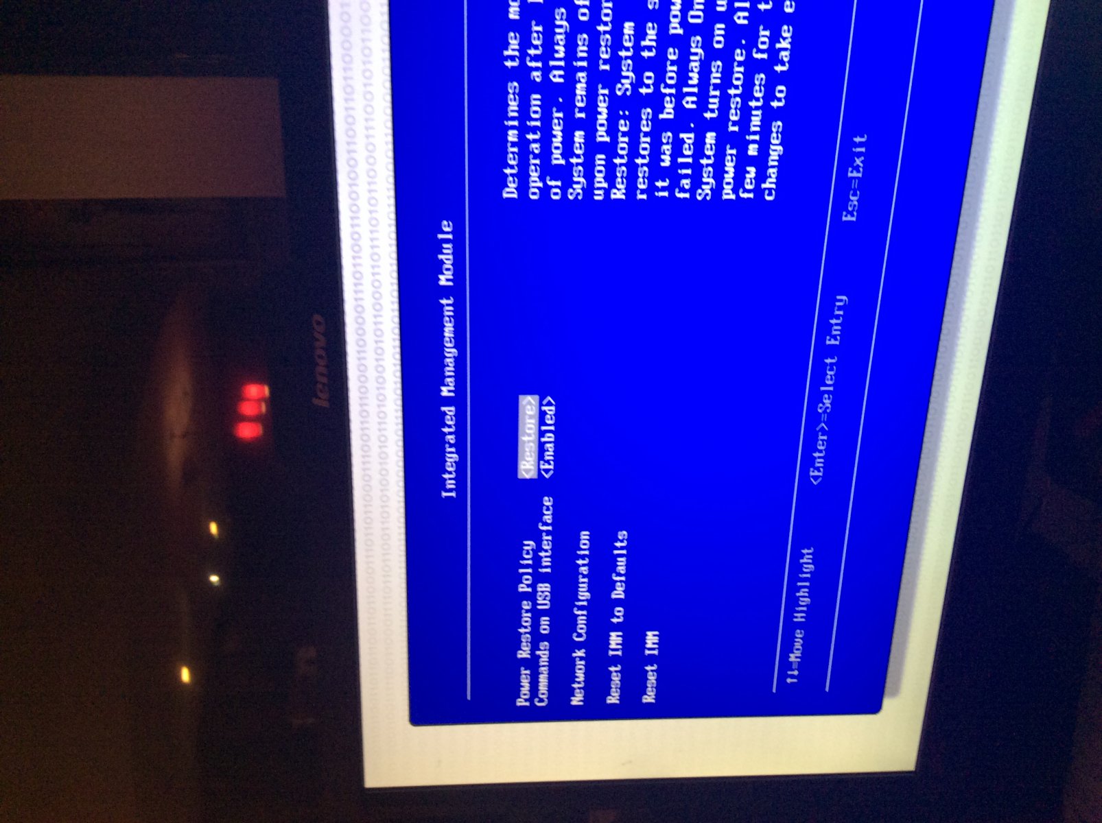

on boot i hit f1 to go to system config window and then i affect stuff in the network config option of the integrated management module settings. the network option doesn't give me options really. screen shots attached.

Integrated management module sounds like ipmi....how many nics total on the back of the server? 3?

i thought so too but i don't think they are related - i'm certainly no expert here though. Attaching a guide guide i found on it. Based on this i might switch the network interface port from shared to dedicated.
I only have 2 available NICs on the back. Someone earlier mentioned they put the IPMI near the mouse/keyboard ports - this server has none.
