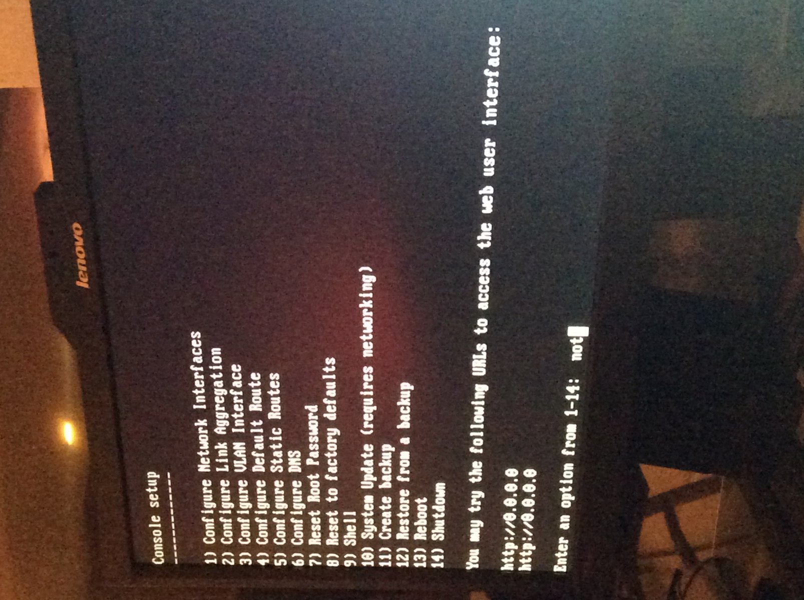

I had a nice set up that i wanted to upgrade to some more powerful hardware. I backed up the config and moved everything over. Reading the forums, i was thinking it would automagically work. It booted but i had 2 jails that were throwing errors and my UPS which i didnt plug in was throwing an error. No big deal, BUT the ethernet ports on the motherboard aren't connecting for some reason. It is telling me to try 0.0.0.0 - no bueno.
I couldnt figure out how to fix this and the error messages kept me from being able to do much troubleshooting. I did a fresh install on a new USB and the network issue still exists. Of note in both instances - the lights near the cable connection are lighting up and showing life.
Any suggestions? I'm trying to use the ethernet ports on the mobo, its an enterprise server, i wouldnt have suspected it to cause these types of issues.

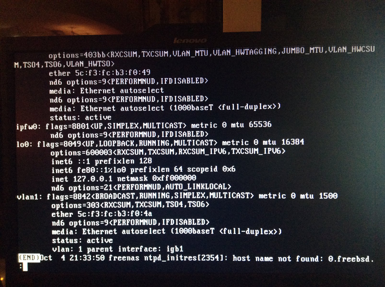

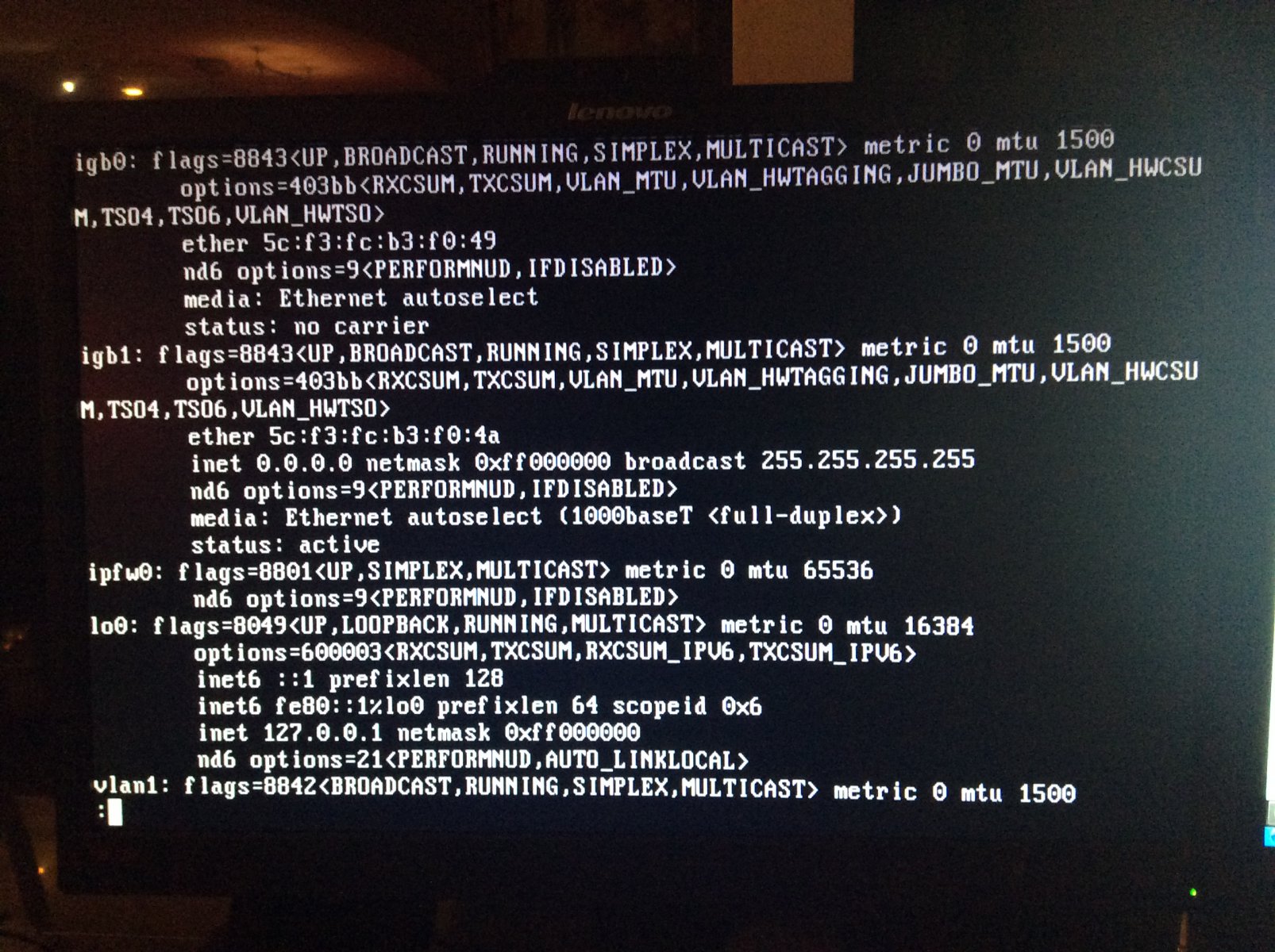

Pretty sure the onboard network ports are intel based on what i've read on other threads. My network interfaces are - igb0 and igb1
Of note and probably related, i get 3 errors for hosts not being found at freebsd.pool.ntp.org.
Also attached are the ifconfigs
Thanks

Apollo
Jun 13, 2013
1,458
You said you did a fresh install, yet you also said you copied your config.
I still suspect your network is not able to locate the DNS server or something similar.
On your screen, press "Enter" and you should see the Freenas option menu.
Select to reset IP and configure LAN again.

Apollo
Jun 13, 2013
1,458
ahh sorry, i meant i just made a copy for when i got his working (havent actually used it yet) - my bad.
Pardon my ignorance, what do you mean by reset IP? not seeing that as an option.
Thanks
You can try option 8 first, reboot and see how it works.
If this doesn't work, try option 1 and set IP address to match your network IP. Select to use DHCP, or don't. I never know which DHCP server this is referring to.
Reboot and see how it goes.
If no success, change option 1 again and change DHCP settigns.
Apr 9, 2015
1,258
Apollo is correct, option 8 to reset to defaults and see how it goes. May also want to only have one ethernet cable plugged in at this point. No need to complicate things with two connections and exotic settings. If it still does not get an IP address go into option 1 and make sure DHCP is selected, if it still doesn't work try setting a static IP in your networks range and try it.

depasseg
FreeNAS Replicant
Sep 16, 2014
2,874
i created a VLAN but it didnt get me anywhere.
Can you explain what you meant by you created a VLAN? Unless you set up your switch and the rest of your infrastructure properly, this could have an isolating effect. I just want to make sure you understand VLAN's.

depasseg
FreeNAS Replicant
Sep 16, 2014
2,874
In that case, I would suggest to leave vlan alone.
Are you sure both ports are connected. igb0 looks like it's unplugged.
Are these the same cables and ports that your old server was using?

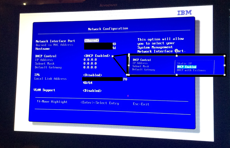

Clinderw
Aug 11, 2013
96
Here is a screen shot of the BIOS too...IP6 is disabled but nothing else looked off to me. Any suggested changes?
Thanks
Oct 2, 2014
925
What manufacturer makes the onboard NIC(s)?
