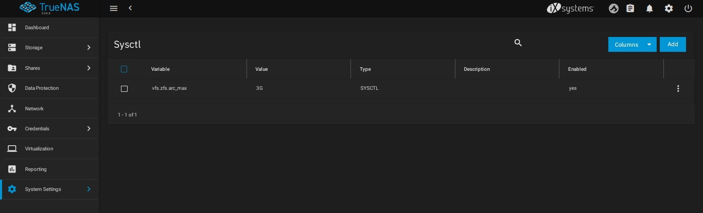

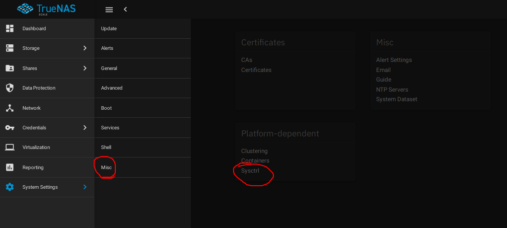

That's what I'm saying, there is no System Tunables in SCALE yet. there is only this misc option under System Settings that gives me this "Platform-Dependent" option of Sysctrl that looks like the system tunables, but being platform dependent I don't think its meant for the Debian distribution that comes on the TrueNAS SCALE ISO.
Screenshots:
