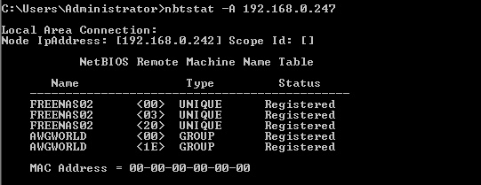

Here is the Freenas log.nmbd:
query_name: Failed to send packet trying to query name AWGWORLD<1d>
[2017/07/07 12:10:42.693956, 0] ../source3/nmbd/nmbd.c:58(terminate)
Got SIGTERM: going down...
[2017/07/07 12:10:43.037686, 0] ../lib/util/become_daemon.c:124(daemon_ready)
STATUS=daemon 'nmbd' finished starting up and ready to serve connections [2017/07/14 11:26:55.846111, 0]
../source3/nmbd/nmbd_workgroupdb.c:276(dump_workgroups)
dump_workgroups()
dump workgroup on subnet 192.168.0.247: netmask= 255.255.255.0:
AWGWORLD(1) current master browser = UNKNOWN
FREENAS02 40809a23 (Samba 4.6.4-GIT-5fe3bc2)
So it looks like that even the Freenas itself doesn't know who's the master browser right?
Attached nbtstat output from my windows server querying the freenas.
Hmmm !?
Hmmm !?
Ugh. None of the windows machines are configured as the preferred master, right? Perhaps try adding the auxiliary parameter preferred master = yes under Services->SMB.
