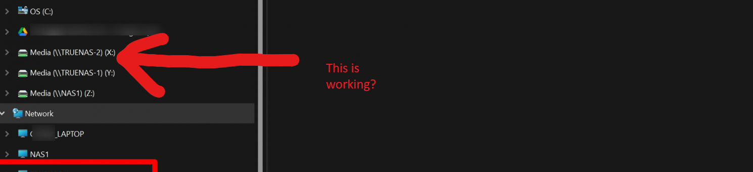

I am running 2 TrueNAS Scale. Windows 11 will only find one share at a time. I can not mount both systems. It looks like both are mounted but if I click into it is really the other system. Any ideas?

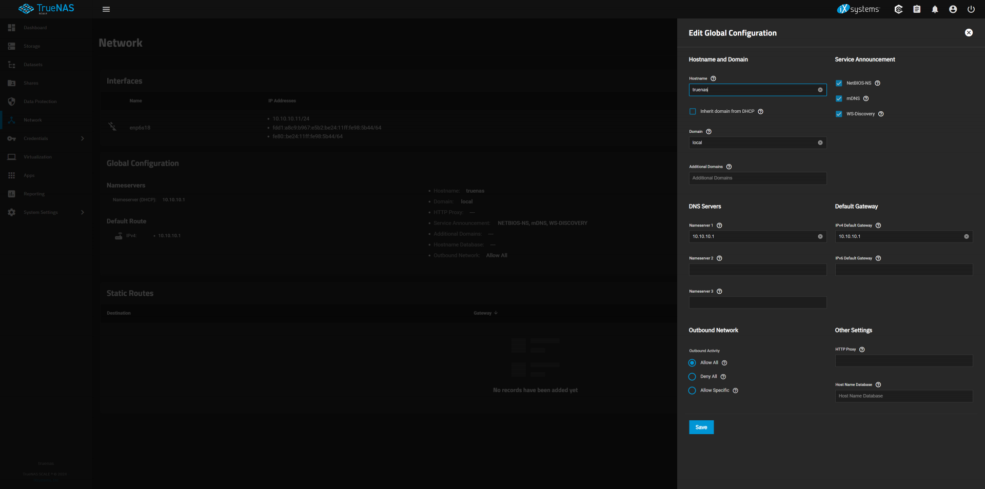

Is this working correctly?
What are your settings under Network -> Global Configuration?
I have also stumbled upon not both my machines beeing visible in network discovery, but I haven't bothered to investigate.

It would be easier if you attached images rather than PDFs.
Just a (personal) notice, I know this will not solve this problem, but do you really need the windows network discovery feature? I have it disabled on my machines and just map network drives, as you also did. I know that you sometimes want to figure out / solve stuff just solely for the purpose of problem solving, but I don't see any obvious advantage of the network discovery working or not. You usecase may vary.
Noted, images from now on.
No the mounted drives are not working they go to the same system.
If the mounted drives went to the correct NAS I prob wouldn't bother.

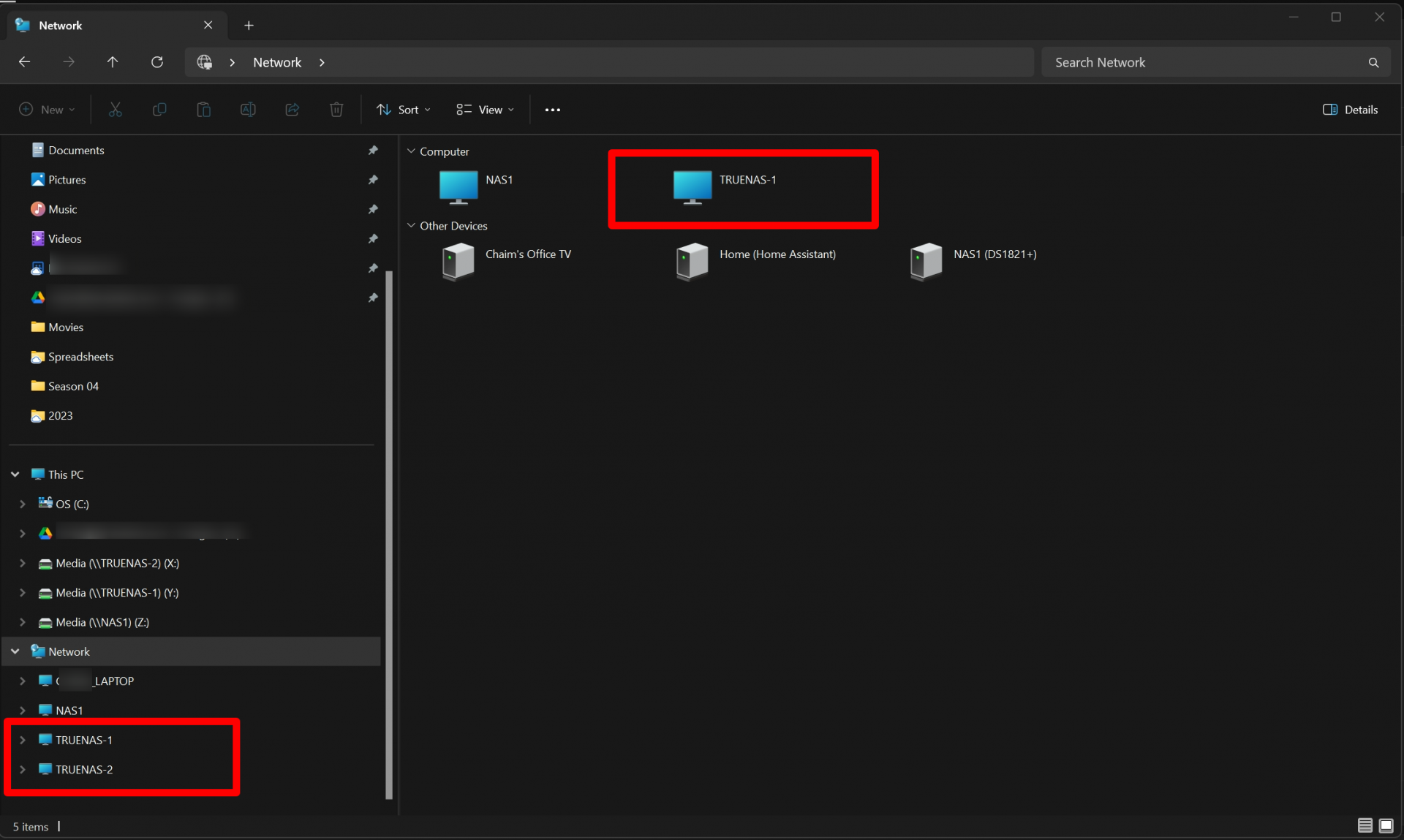

uncleleo88
Oct 25, 2023
8

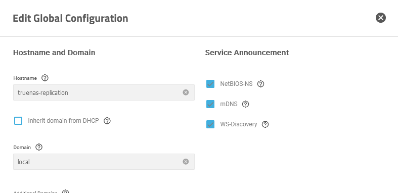

You made me realize I should prob not have the same host name for both system. I changed it and now they both seem to be working.
