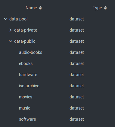

Probably it was not a good idea what I have done ... :rolleyes: ... (on FreeNAS-11.2-RELEASE-U1). My intention is having different Snapshot tasks on nested datasets.
I added several datasets as you see in the picture below. All kept their default settings. Then I shared data-private and data-public via SMB with "Export Recycle Bin" enabled. SMB sharing changed the dataset share type of data-private and data-public from Unix automatically to Windows. Nested datasets kept share type Unix (so far I'm fine with it).

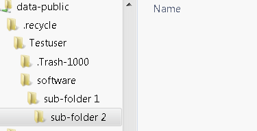

On remotes machines either Windows or Ubuntu deleted files in e.g. data-public go directly into data-public/.recylce folder (with Ubuntu 16.04 first into .Trash folder). Nested datasets are accessible by the share as well. But files deleted within nested datasets are deleted completely (same for files in sub-folders) - files doesn't end up in data-public/.recylce. However the funny part a sub-folder tree is created. In addition I changed the share type from one nested dataset to Windows but behavior stays same.
  • nested datasets shouldn't be used underneath SMB shares?
  • any recommendations about share type of nested datasets?
  • what's a good reason for nested datasets?
  • network shares should be created at "deepest" dataset level?
Just started moving from Ubuntu server 14.04 LTS to FreeNAS 11.2, so far I'm quite happy :)
