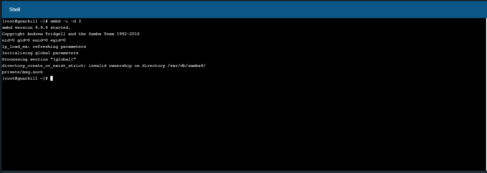

SMB will not start. Running 11.2 stable.
SMB worked fine on my first install but I screwed up permissions so bad somehow Freenas wouldnt even start so I reinstalled and reimported my pool.
I've reinstalled twice now with the same result.
Vanilla install smb toggles on. I reimport my pool and add a smb share, it loads for about 30 secs and says "call timeout" real small in the corner. After that SMB will not start. Even if i delete the smb share it still wont start.

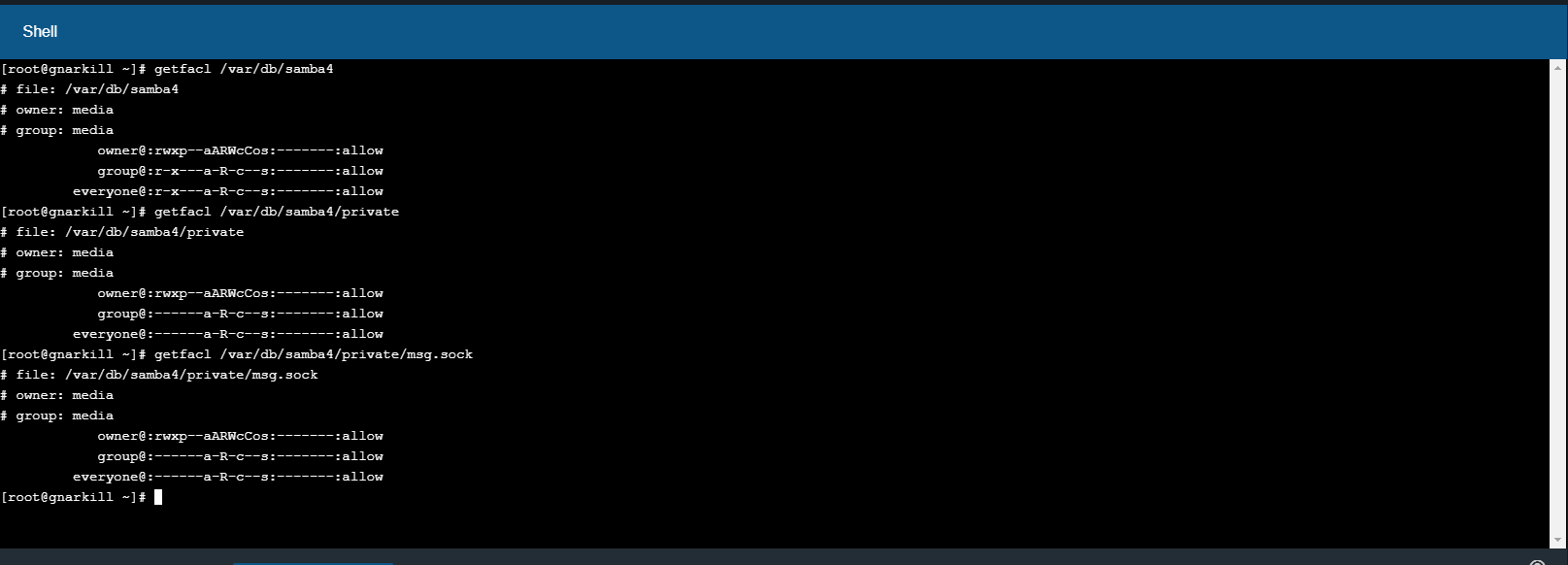

Post output of
getfacl /var/db/samba4
getfacl /var/db/samba4/private
getfacl /var/db/samba4/private/msg.sock
well thats not right....this is why I reinstalled before..

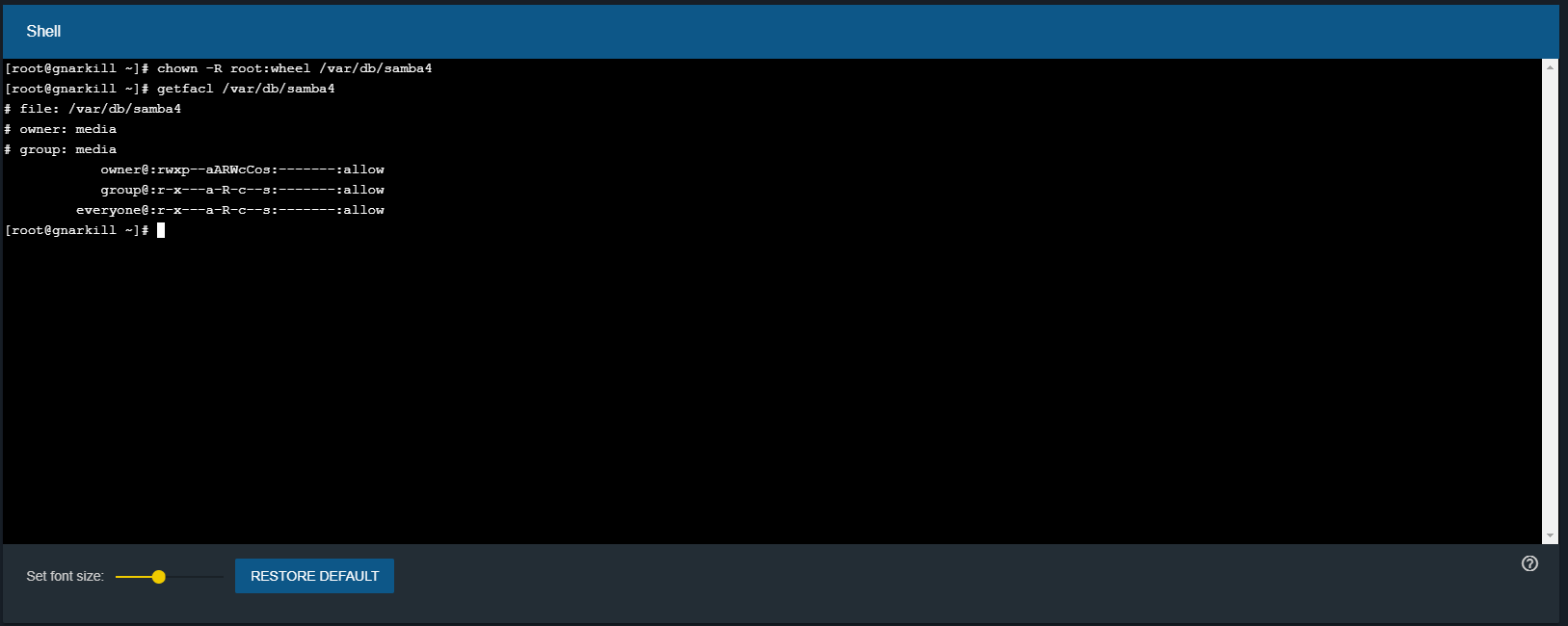

chown -R root:wheel /var/db/samba4
seems like its not taking affect

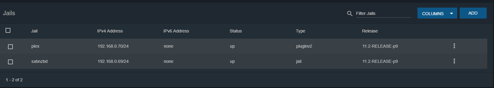

What jails/plugins are you using? Have you mounted any storage inside them?

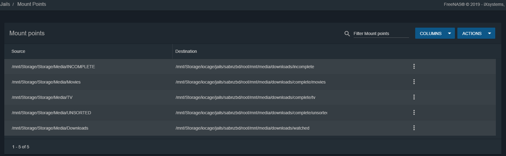

im running a jail for sabnzbd and a jail/plugin for plex and ive set up mounts in both just fine. although in my sabnzbd mounts i would start having write issues to the disk if i tried to add a smb share and id have to re-chown the mount points
I setup permissions for sabnzbd and plex like this
service sabnzbd onestop
chown -R mediauser:mediauser /usr/local/sabnzbd
sysrc 'sabnzbd_user=mediauser'
chown -R mediauser:mediauser /usr/local/share/sabnzbdplus
chown -R mediauser:mediauser /var/run/sabnzbd
service sabnzbd start

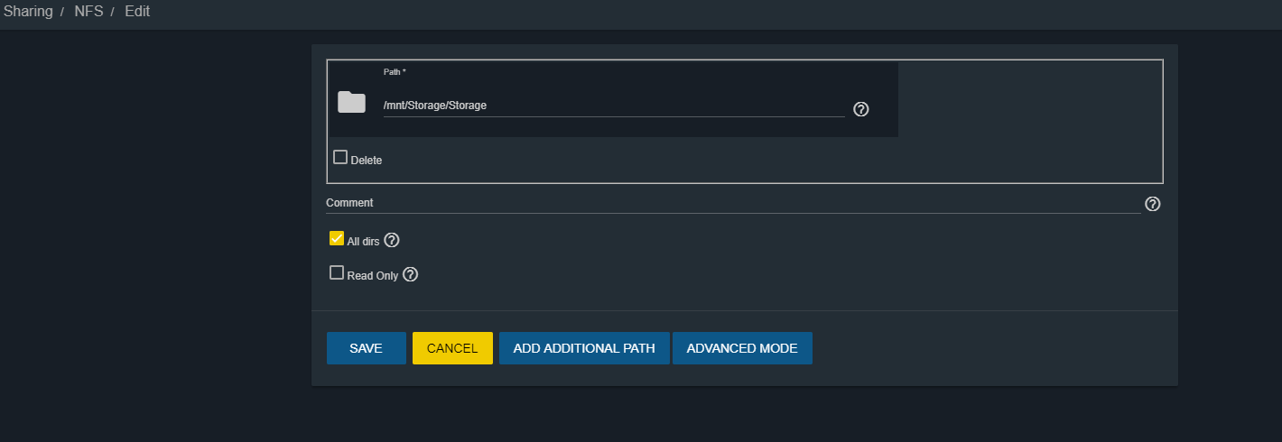

also not sure if related or not, i have an nfs share mounted as root user on windows 10 and i cant open anything or write but i can view the files

Postmortem:
Issue was related to permissions on /var/db/samba4. Since that path is a symlink to /mnt/<pool>/.system/samba4, it was most likely affected by a permissions reset on the parent zpool. We do have some safeguards in place to prevent this from happening, but I will investigate if we need more.
