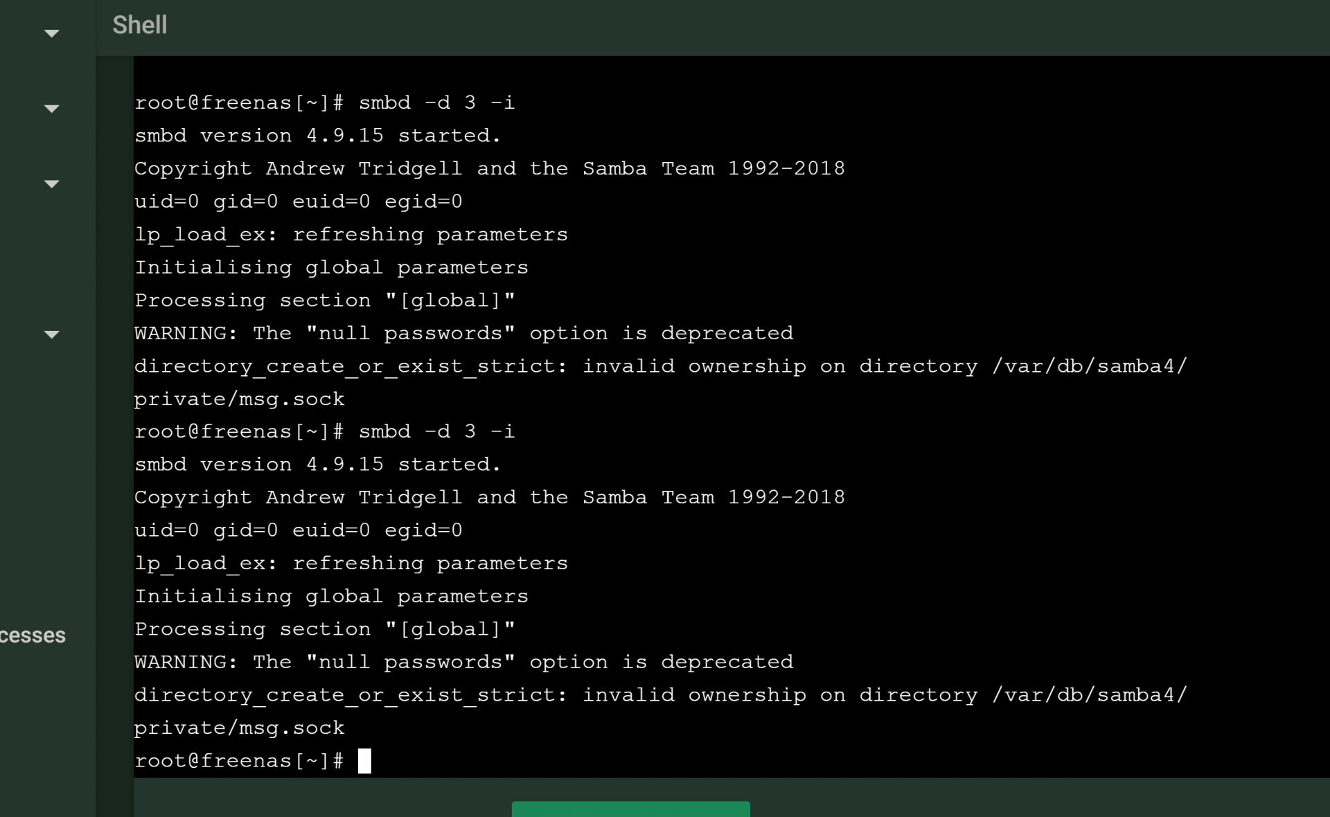

I have just done a fresh install to 11.2.U7 and keep getting the message SMB failed to start. I have given permission under Group/User, Under sharing added path to my share and given permission to assigned user/group and under storage given permission to user/group. I am at a lost. Any idea? When I run SMBD -d 3 -i I get attached.
Thank You

Thank You for taking your time to help. Didn't work for me but really appreciate the help.

Hello all. Couldn't figure out how to fix so I installed the beta 11.3RC2. No issues now. Love the new system.
