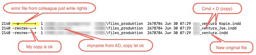

ok, unfortunately my colleague who also works with Ventura tried it out and he has problems with the rights. When he duplicates a file with Cmd + D, this file receives the wrong rights:

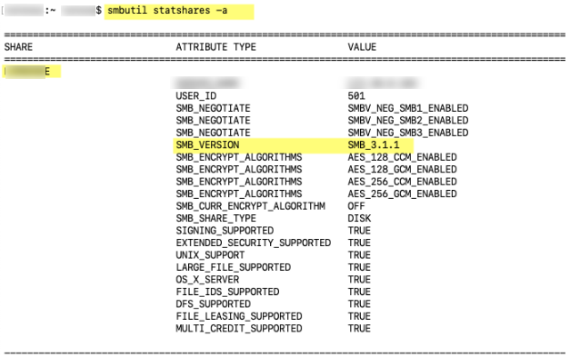

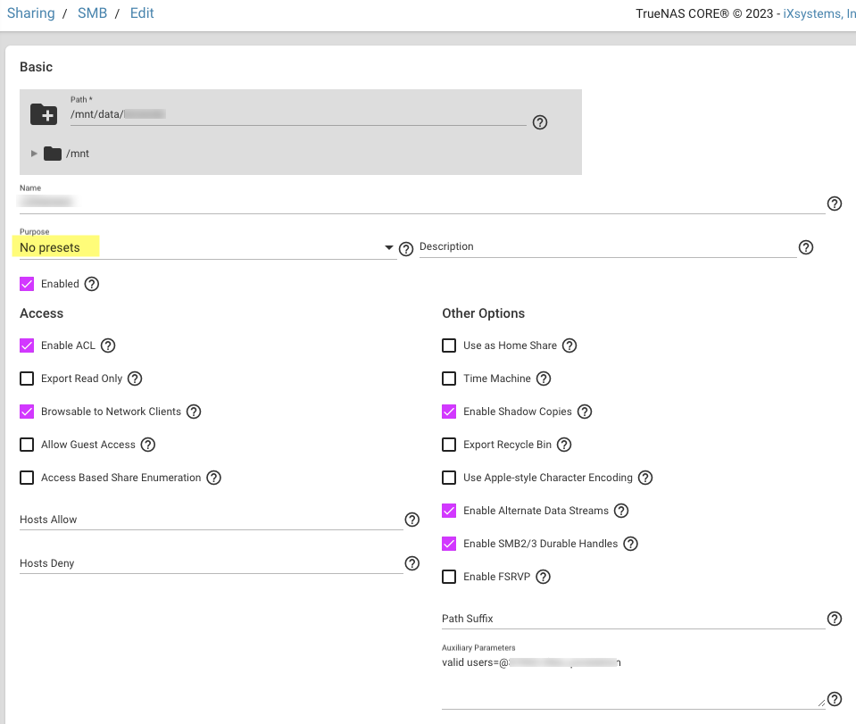

Here are the config on the mounted volume, SMB 3.1.1

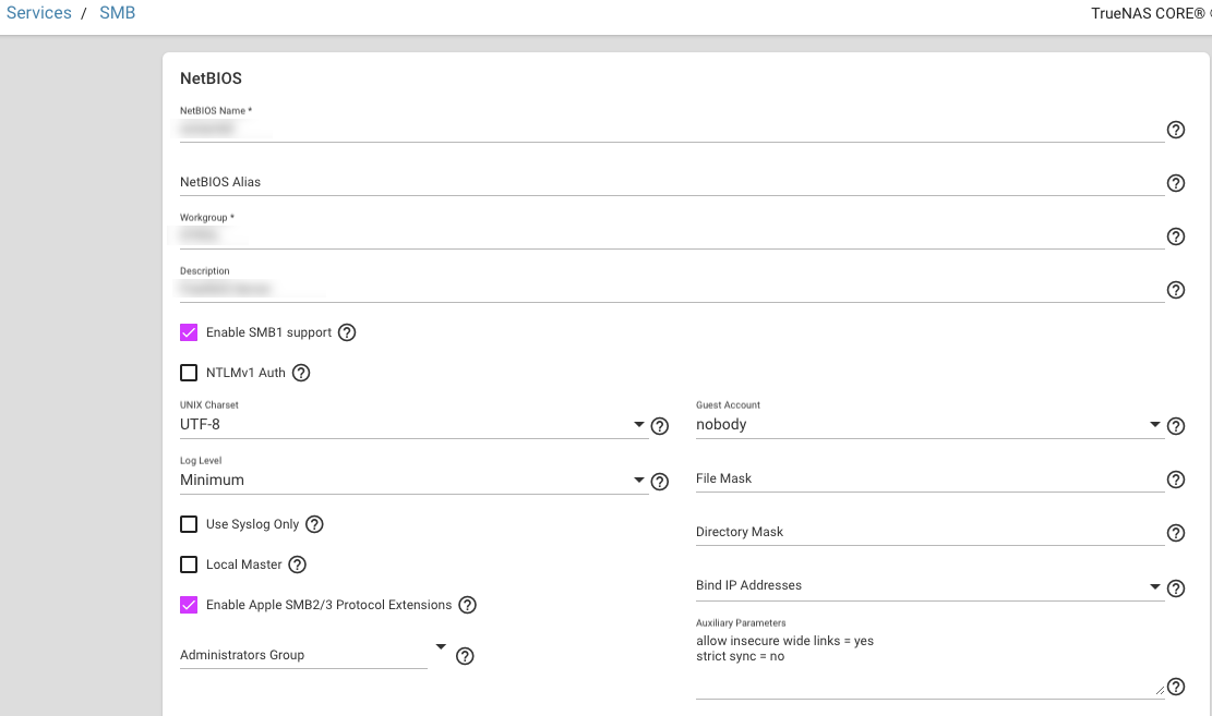

7. Apple support checked in SMB global config.
I have this same setup and all works well so trying to understand what’s different between us.

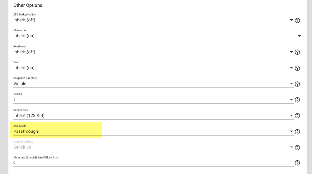

Hello @johnny, thank you for your input. We created a completely new share and left all permissions by default. Then we tested everything and it seemed to work fine. Then we compared all the individual settings with our old one and found that under Storage > Pools > Edit Options the ACL Mode was different. In the newly created test share, the ACL Mode was Passthrough, while in our old share it was Restricted. We have now set the ACL Mode to Passthrough everywhere and duplication now seems to work. We will now test this on several Mac OS including Ventura to see if everything is really OK.

Great so looks like dataset wasn’t set to SMB then?

Yes, we use SMB with the following setup. Unfortunately, there are still some problems with Adobe Illustrator, both with Ventura and e.g. with Monterey. For example, if you want to export a PDF from an AI document, AI creates a .tmp document without permissions. After that, you can no longer delete these .tmp files until you have reset the ACL permissions.

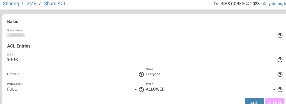

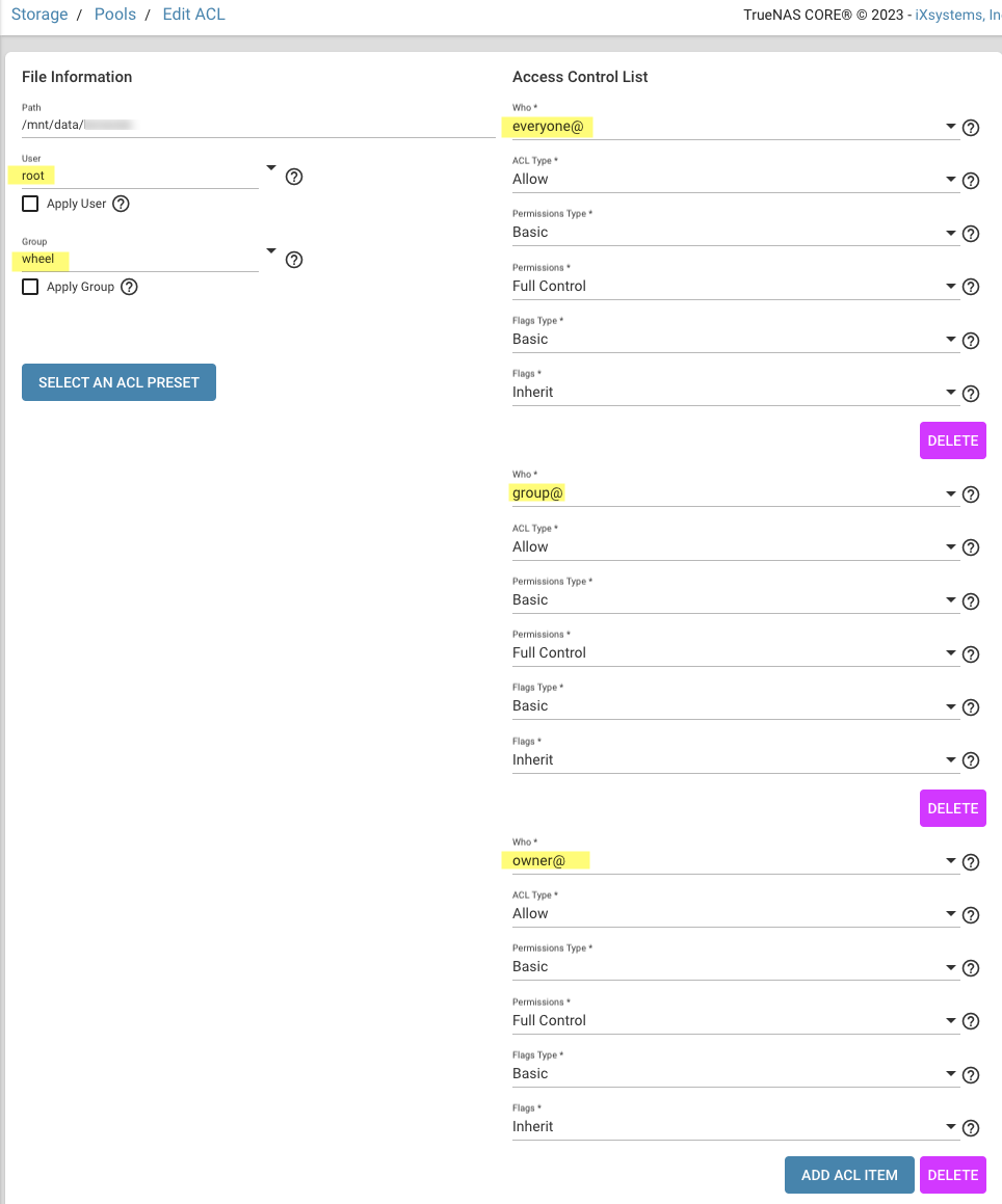

Hello Johnny, for this share the current settings regarding the ACL's look like this:

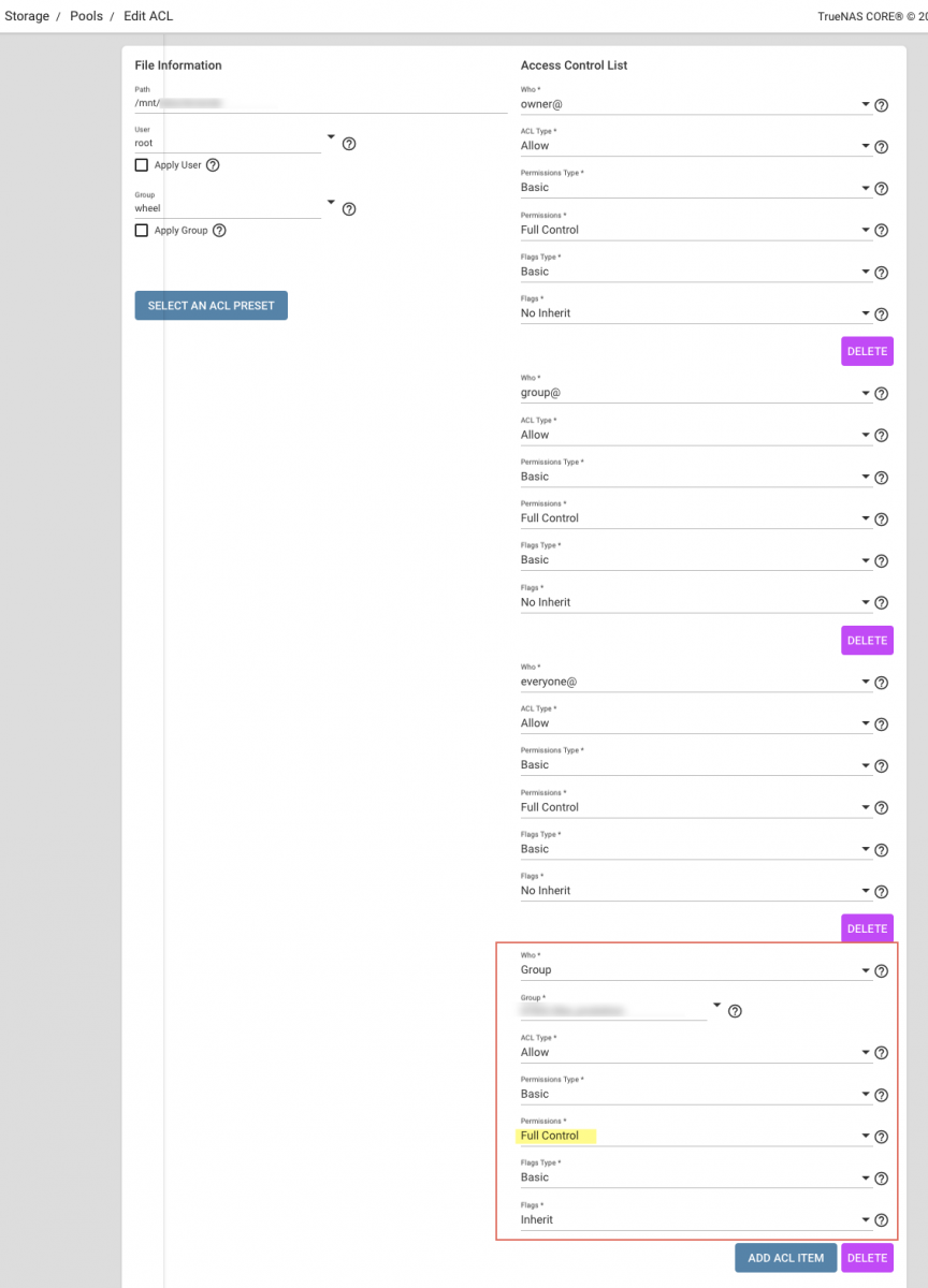

Hi @johnny, also the last problem (Illustrator and .tmp files) seems to be solved now. We have various older Macs in the company that are not pure Local Mac users (Admin) but still have a Mobile account (Admin, Mobile). These Macs on the network behave differently than pure Local Mac users. Apple or Adobe don't seem to be working properly here. To work around the issues without having to do a clean OS reinstall, we solved the permissions issue on the server with TrueNas. We added a fourth position under Edit Filesystem ACL, user@, group@ and everyone@ with group, this seems to fix the Apple/Adobe errors afterwards and so far it seems to work fine :)

You shouldn’t need any of the other ACEs like owner@ group@ or everyone@ so long as all your users are in the ‘group’ you added as the final entry.
