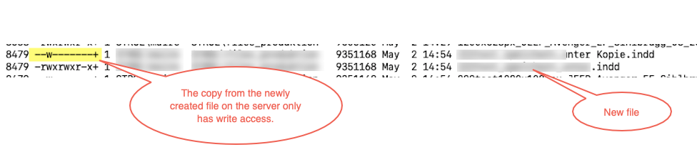

Hello,
we have now the problem that new files, which are created on the server, do not automatically receive the correct permissions. For example, if I create a new file from an existing Indesign file with "Save it as...", and then I duplicate it in Mac using "Command + D", then this copy only receives the write permissions, the file is copied correctly, but the permissions are unfortunately not automatically written to the end, see screenshot:

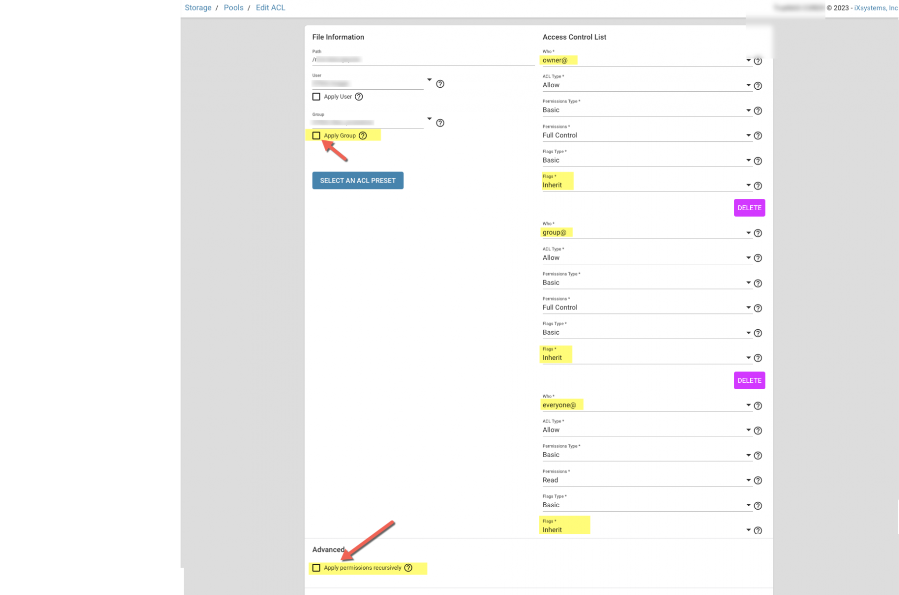

How can I set TrueNas so that the rights are automatically assigned for future new files? The flags under Edit ACL are defined as Inherit for Owner, Group and Everyone.
At the moment I solve the problem manually by overwriting the rights in Truenas 13.0-U4 with
Edit "Filesystem ACL" under Sharing > Windows Shares (SMB) with Apply Group, with Apply permissions recursively,
then everything is fine until a new file is created on the server:
Does anyone here have a tip on how I can solve the problem permanently?

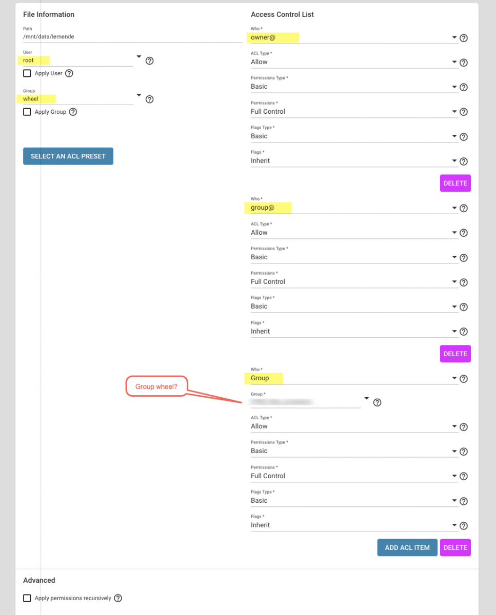

I normally leave the owner as root and group as wheel and set permissions via ACEs. You could try that on another dataset and share and see if you get the same behaviour perhaps?

ok, here I am again. I tried with owner -> root and group -> wheel, but unfortunately it didn't work.
The problem always occurs when a new file is created directly on the server and then duplicated with Cmd + D. The duplicated file then only has write access and can no longer be renamed or deleted.

Have you left the owner@ and group@ ACEs?
Jul 3, 2015
926
Lose the the owner@ and group@ and see if that’s any better.
I assume the hidden group is the name of the group you created on TrueNAS or AD?
exactly the hidden group comes from the AD. I will delete the owner@ and group@ and test them. I will report back... thx :)
JoeHöpfner
Mar 23, 2023
22
ok, I deleted owner@ and group@, then all files had no rights, see screen. In the meantime I think it is the OS, I work with Mac Ventura and everything works for me, other colleagues work with Catalina and there the problems appear.
Jul 3, 2015
926
Once you have made that change you will need to restamp permissions. Tick the box 'Apply permissions recursively'.
