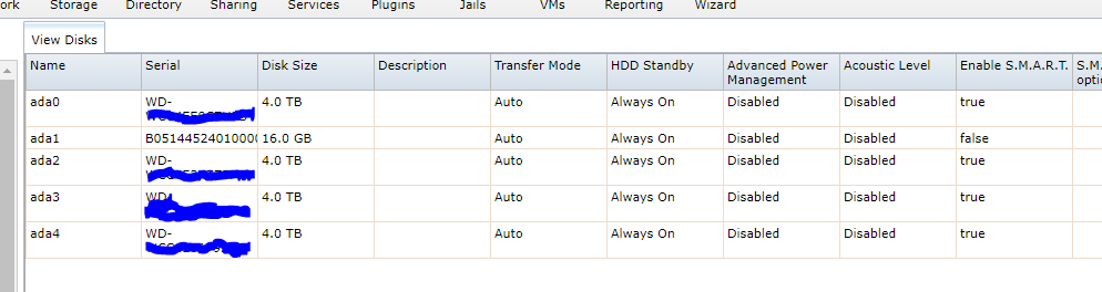

Hi, guys.
I'm having trouble understanding why the SMART tasks I've set up don't run. I'm new to this, so it is quite probable that I misinterpreted how the FreeNAS guide described the feature.
I scheduled the tests (see image) for the first time on Monday, so I was expecting one to run on Tuesday, yesterday, and tonight. Well none have run, and I see none scheduled for ada0 and a couple of sporadic, odd ones for ada1 and ada2. I've rebooted the machine, but no change. Can you please point to what I'm doing wrong?!?
![vg1gI1W.png](https://i.imgur.com/vg1gI1W.png)
![rXED7NM.png](https://i.imgur.com/rXED7NM.png)
