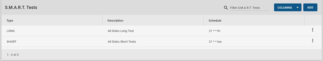

4-Checked 'Tasks > S.M.A.R.T Tests' and found two, one 'Offline' and one 'Short' but no disks selected. So no tests being done.

6-I deleted the tests in 4 'Tasks > S.M.A.R.T Tests' that had no disks selected
7-I created two new tests for all disks in 'Tasks > S.M.A.R.T Tests' on Long and one Short encompassing all disks.
8-I ran 'smartd -q showtests' and now it reflects the tests I created with all disks to be tested over the next 30 days.
