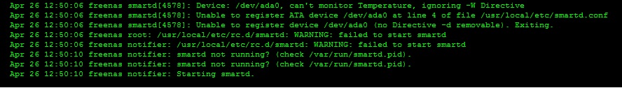

Hi guys
I have my FreeNAS running with 4 HDDs and one SSD as ZIL device. When i try to configure a SMART test and include my SSD (ada0), then the SMART daemon stops working (see screenshot attached), when i remove the SSD it works again. When i manually try "smartctl -a /dev/ada0" i get my SMART data.
What is the problem here?
Cheers
Thomy

Bet that when you run the test manually you don't have a TEMPERATURE value. this actually might be something worth looking into however I also realize you're new here but you need to provide the required minimum data so we can give you proper advice.
If you notice joeschmuck was correct. Not sure how flexible the GUI is with this, but maybe create a seperate test for the SSD without checking for temperature if possible.
Nevermind. Looking closer it's exiting on (no Directive -d removeable). What does your smartd.conf look like:

If it's saying "unable to register device, no directive -d removable", I think that means it couldn't find the ssd at that time.
I'd be wondering exactly why, but you could try the following in "smart extra options" under "view disks - edit".
-a -W 0 -d removable
The -W 0 will get rid of the temperature warning. -a tells it to enable all the regular tests. The -d removable tell smart to run even if it can't open that particular device. Again, I'd be wondering why it can't open it at that time.
