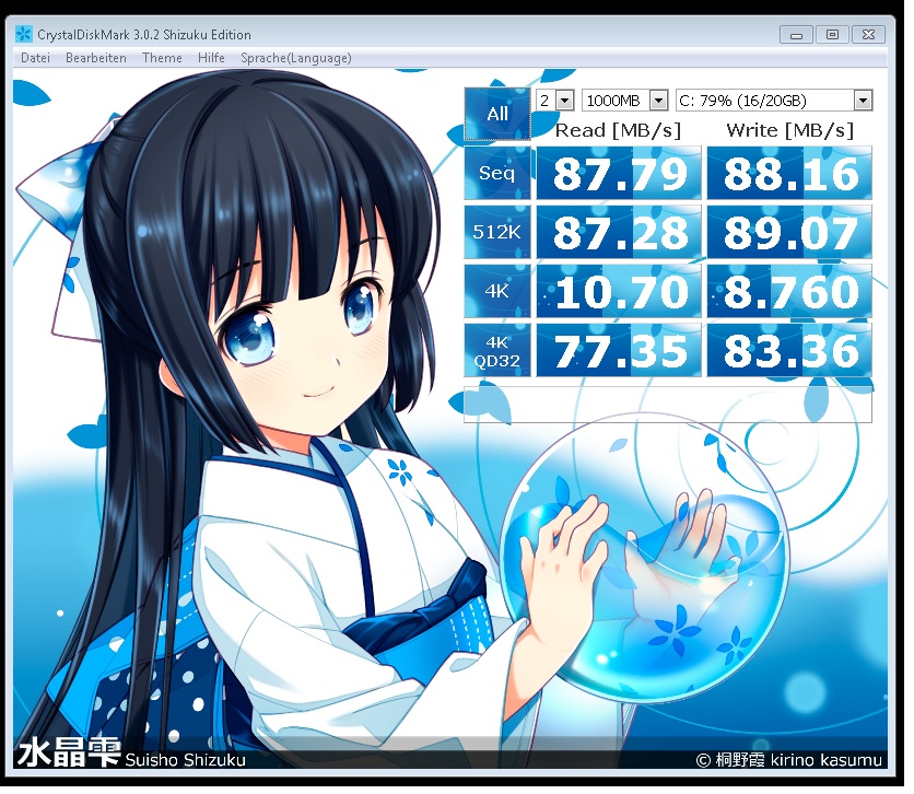

I have the problem, that with my ESXi 5.5. (with 5.1U1 the problem is the same) setup (ISCSI storage via FreeNAS) the random write speed is very slow, see attached screenshot (Bench1).
The unit consists of 4 2TB HDDs together with a SSD as L2ARC, 8GB RAM and a XEON E5345.
The ESXi is attached via 2 different gigabit ethernet links, however enabling/disableing MPIO doesn't change anything.

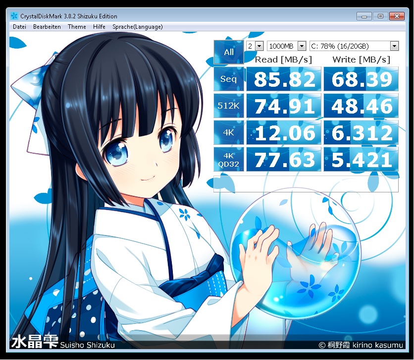

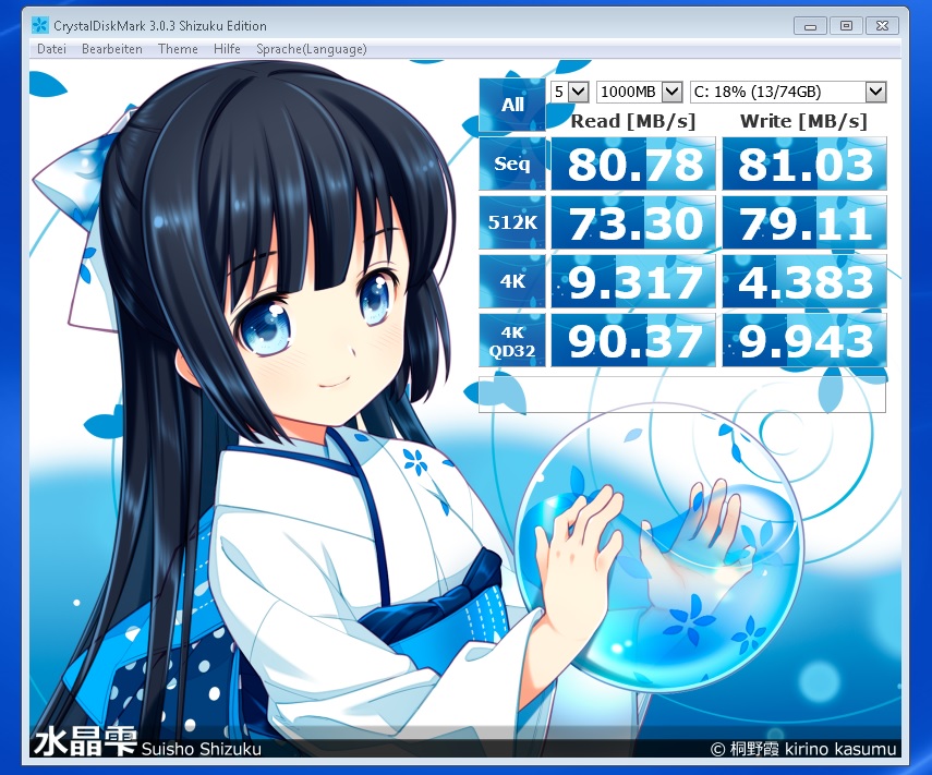

When running 8.3.1, i had no seen this behaviour. However i had to enable the "vfs.zfs.no_write_throttle" tuneable, and this only took effect when the hardware had 4 CPU cores (see the 2 additional screenshots).
Does anybody of you know what causes this behaviour in 9.2.0?

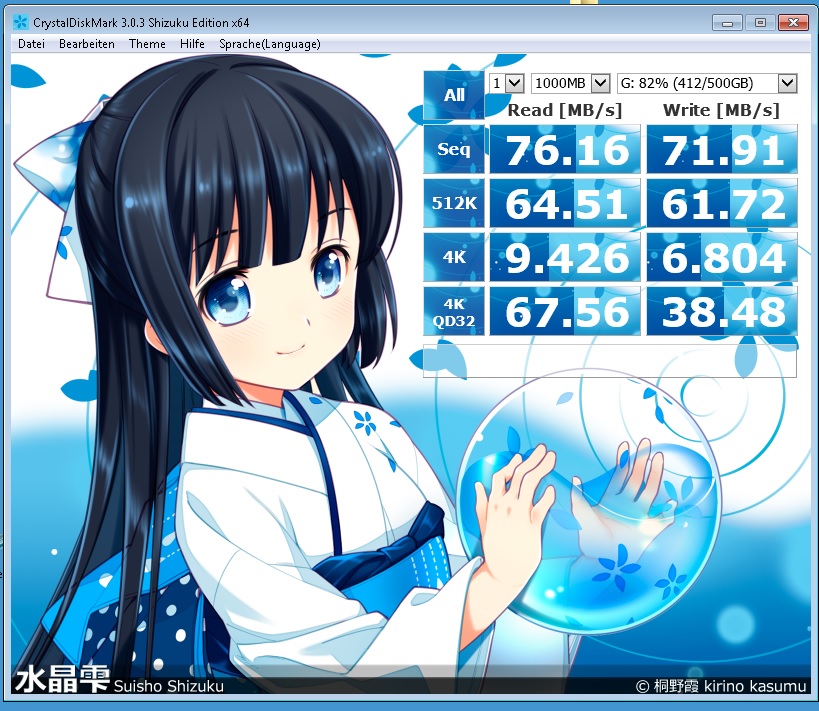

Now i created a Zvol (with the default cluster size of 8KB) and made another datastore.
When i test on this, i get a quite better result, see screenshot attached.
Is there any explanation for this?
jgreco
Resident Grinch
May 29, 2011
18,680
I have more than 10% free to reduce fragmentation.
I read this as "My pool may be as much as 89% full." Which is way too full. You really need at least 50% free space in the pool, quite possibly more, to reduce fragmentation effects.
Basically there seem to be a lot of things wrong with what you're doing. I don't really have a lot of time to guess at which thing is going most wrong for you. For VM storage, the recipe I've been looking at is documented here and elsewhere.
