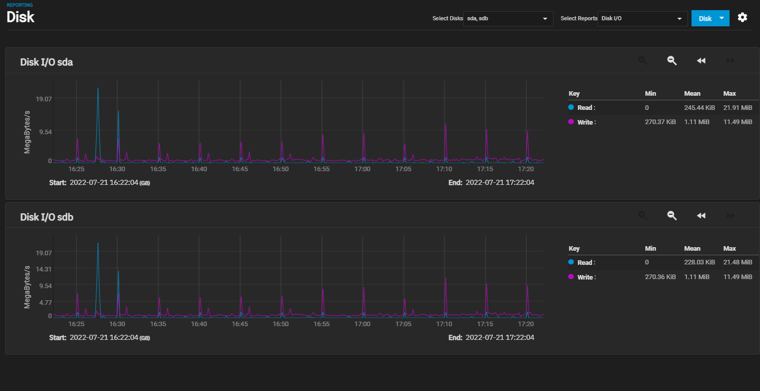

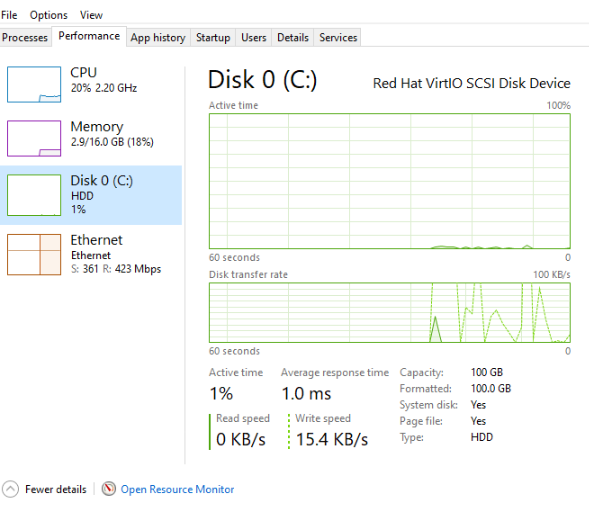

While running some basic sync tasks on the VM this is my disk activity as reported by Windows
During the same time TrueNas report my SSD disk activity the below
I had allocated more CPU cored to the instance as I was also using a schedule 7Zip archiving activity, it is to be said this is not running, and is not the cause of any sluggishness. I could try lowering the core count to see if that helps with any performance issues.

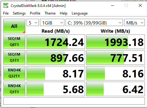

I recently installed a Samsung 980 Nvme into the system and I have moved the VM from my SSD onto that to see if there was any difference. There however is no noticeable difference.
So I downloaded and ran CrystalDiskMark and ran:
Not really the performance I was expecting.
I have installed the latest drivers within windows as per: https://fedorapeople.org/groups/vir...ownloads/archive-virtio/virtio-win-0.1.221-1/
But still feels sluggish. Perhaps I used the wrong drivers during initial Windows install as the my VirtIO HDD drivers show as:
Any ideas ?

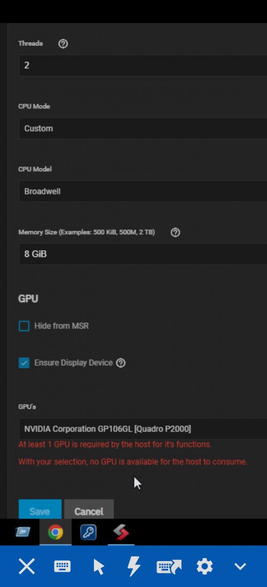

Hey .
Yes the GPU uses a VirtIO driver. However I cannot select a GPU to pass through as I get an error as per the below.
Unless I am doing something wrong?
diogen
Jul 21, 2022
72
I think this is work in progress...
panzerscope
May 30, 2022
146
Understood. Looks like a limitation I will just have to wait and see if it is overcome. Thanks for letting me know. I think you are right that some of the sluggishness us down to lack of GPU acceleration.
