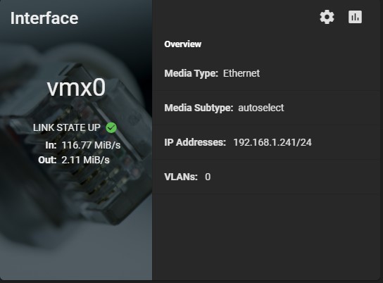

seanmcg182
Feb 14, 2021
18
TrueNAS interface splash while transferring files... the slower one was taken less than 10 seconds after the fast one.

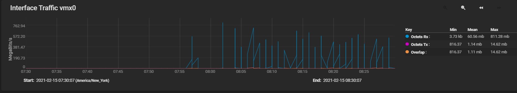

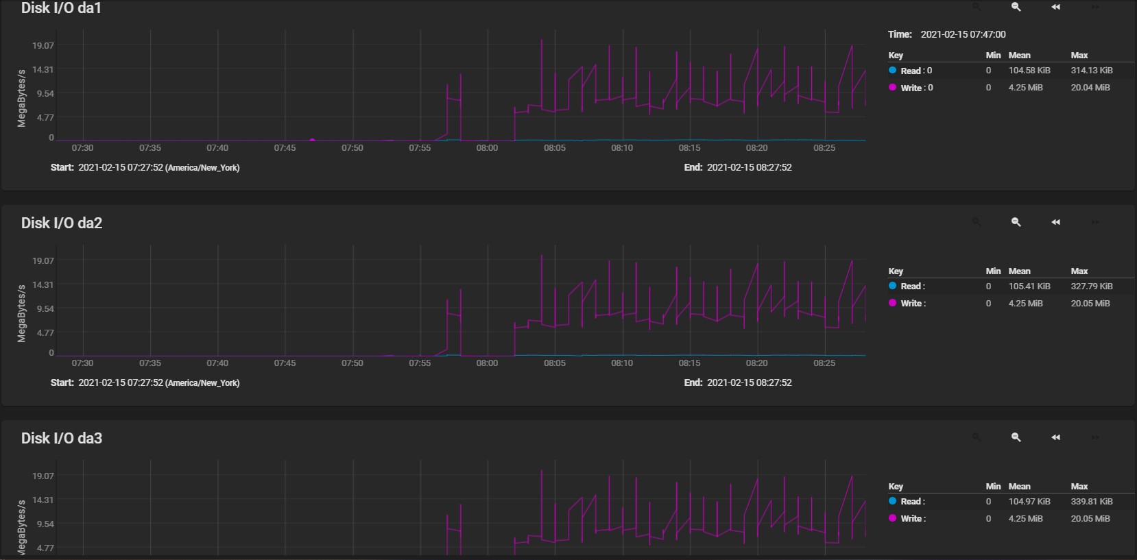

seanmcg182
Feb 14, 2021
18
Another 2 pictures showing the Network Traffic and Disk I/O form TrueNAS Reporting section.
(Sorry for so many replies, can't find out how to edit original post.)
no_connection
Dec 15, 2013
480
6 cores? How much co-stop are you seeing? I would suggest to start with 2 unless you do transcodes(I would have a separate VM for that anyway).
Pretty sure vmx is 10G, it is for me with vmxnet 3. So I would not try to force it to go 1G.
I am not up to date for v12 but look around for bug reports concerning speed.
While I don't agree that you can't run it in a VM, do make sure you read all stickies and other information and do proper risk calculations and have ways to handle for things to go wrong.
