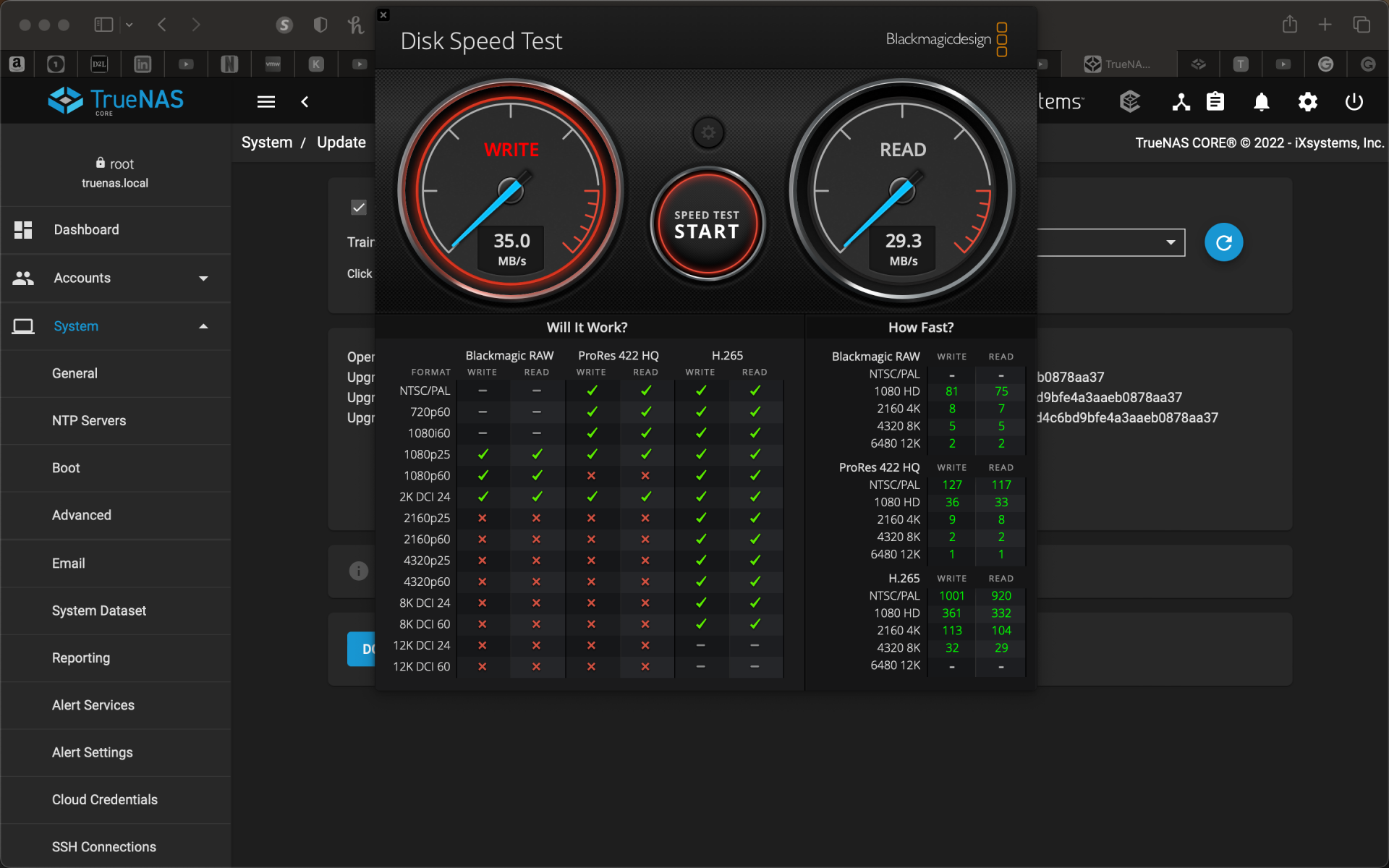

Can u guys help me please?? i use SMB to back up my mac using time machine, I'm only getting 30MB/s even when I'm transferring regular files like videos.

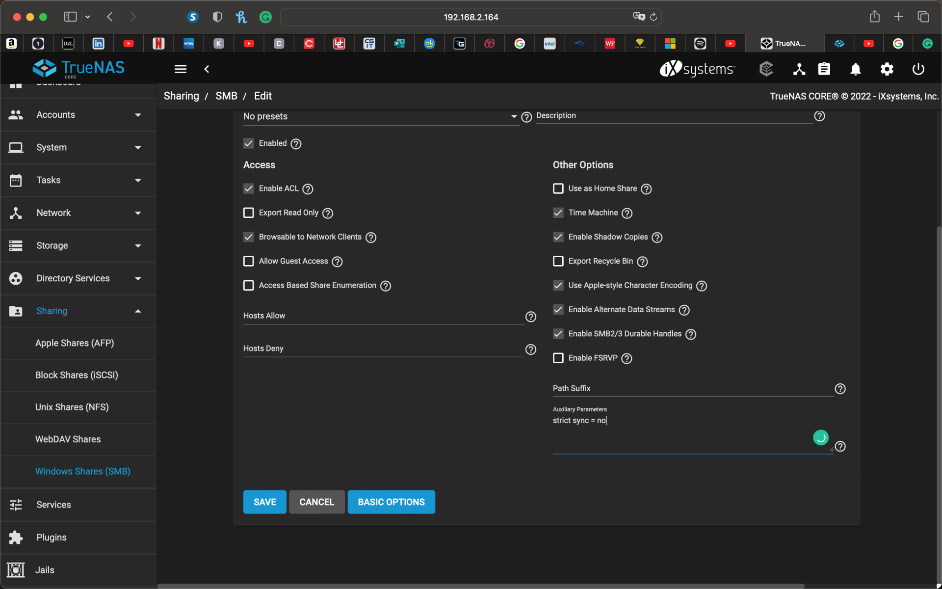

As you're on a Mac, try disabling SMB "strict sync"
In the SMB auxiliary settings (Services -> SMB -> Little Wrench Icon) add a line that says strict sync = no
Restart the SMB service afterwards, and try a copy again.
Here?????

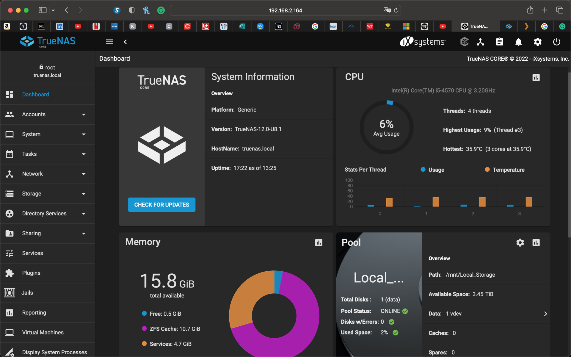

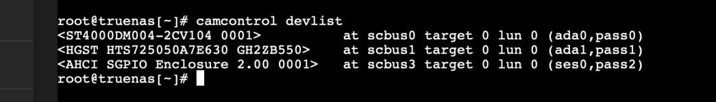

Can you provide some further hardware information? I see that you're on likely consumer hardware, from the i5-4670 CPU, and 16GB of RAM - but you also only have a single data disk, probably a 4TB. Do you know the model, or can you post the results of camcontrol devlist when run from the shell/SSH?
thanks for helping me. Yah i do have only one drive there cause I don't mind losing data if the drive fails. i did installed truenas thru Hyper-V before I was getting the same speed "30MB/s" from my mac but when I use the local host I used to get 300-400MB/s easy...

Apologies, somehow I missed the notification on this - one of your drives is listed as a Seagate ST4000DM004 which is known to use shingled magnetic recording or "SMR" - these drives can have very poor performance characteristics under "rewrite" scenarios. Is the pool you're copying to using that Seagate drive?

it’s okay… what I realized the other day is that when I plug one of my pc’s directly into the router build-in switch I get 150MB/s easy however I get 25MB/s over the wifi

25 MB/s over wifi are OK thats 200mbit/s if you Alt click the wifi icon on your mac you see additional info on your connection I would guess the tx-rate is 400mbit/s with all the wifi overhead 200mbit/s is a normal value... and the wifi connection is fore sure the weakest link in your chain...
