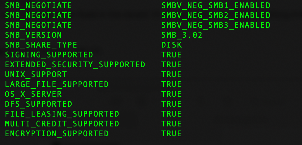

It sounds to me that you might have client signing still on. It's on by default for the last few versions of macOS.
In terminal with the SMB share connected run: smbutil statshares -a
It will tell you if you do and so I suggest you consider switching it off and retest.

Here's what I get from terminal. This is on Catalina. I guess the signing issues are only older OS versions? Here signing is off.
