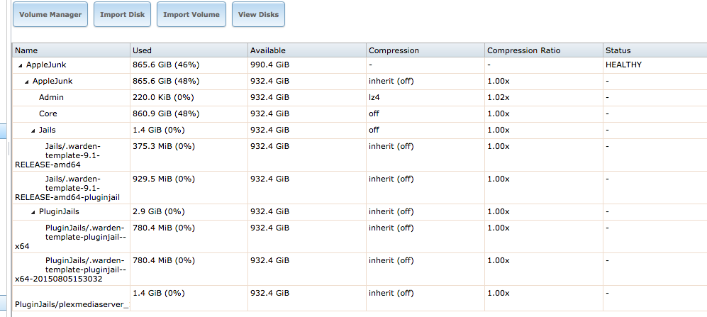

Hi all,
I have been reading the forums and trying what I could do to find the problem but to no avail. I need some help please. When I transfer files, I get about 30-50 megabit per second read/write. For example, it took 12 mins to transfer one 2GB file to the NAS in a test. It took about the same time to read it back from the NAS. Additionally, when I look around my NAS with Explorer or Finder, it takes a long time for folders to populate or drop down after being clicked. Also confounding, when wired, my Mac required hours to transfer the same 2GB file - much slower than wifi. Odd, huh?
Motherboard: ASUS H81M-K
CPU: Intel(R) Core(TM) i3-4160 CPU @ 3.60GHz
HDD ada0: Seagate NAS HDD ST2000VN000-1HJ164, 5900rpm, 2TB
HDD ada1: Same
RAM: 8GB, Non-ECC, (2x) kingston khx1600c9d3/4gx
em0: <Intel(R) PRO/1000 Network Connection 7.4.2, PCIE, Gigabit>
Router: Actiontec MI424WR Rev I (Gigabit), Wireless -N, -G
ZFS ver 5: Mirror 0
1 ZFS pool.
1 ZFS CIFS share.
CIFS sharing, FTP, and SSH are enabled.
FreeNAS connection to network: wired
Compression: off
I have a Plex jail installed; however, i turned it off for this testing in hope that things would improve. That didn't help at all.
IPERF Results:
33 Mbps avg from a Windows client with FreeNAS host
GUI reporting values during a 2GB write followed by 2GB read (FreeNAS 9.3):
CPU usage 99% idle
System load .03 max in last 5 mins
Disk 1 read 153 avg, 11k max (yes 153, not even 153k)
Disk 1 write 343k avg, 4.8M max
Disk 2 read 216 avg, 13.2k max (yes only 216)
Disk 2 write 373k avg, 4.8M max
Physical memory - Free 723M max, Active 213M max, Cache 3.1M max, Inactive 470M max, Wired 6.4G max
Network (em0) RX 33.6M max
Network (em0) TX 1.7M max
ARC size 5.7G avg, 5.8G max
ARC hit: 99.41 avg
I'm stumped. Speeds are pretty much equivalent via PC wifi and Mac wifi, so the CIFS protocol does not seem to be the issue. My PC is a Surface Pro 3, so it's wireless only. I was only able to test wired transfer via Mac.
Do i need to check my network settings? If so, how?
Ideas? Thank you for your time & help in advance :)
