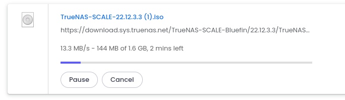

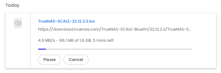

Hey @xtj7
What kind of download speeds do you get from this CDN in comparison to the other one?
https://download.truenas.com/TrueNAS-SCALE-Bluefin/22.12.3.3/TrueNAS-SCALE-22.12.3.3.iso
From yours:

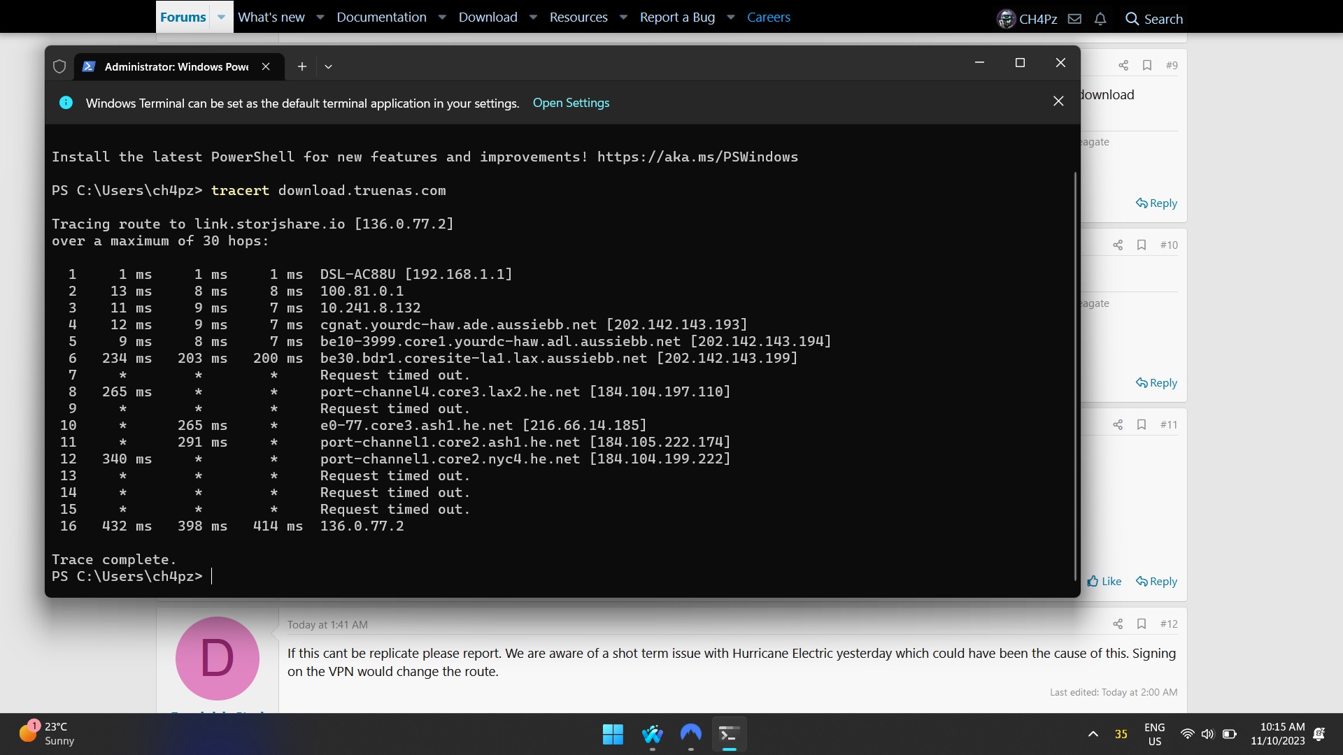

Appreciate the alert @CH4Pz, could you provide a traceroute to download.truenas.com with your VPN off?
Didnt really know what a traceroute was, so had to look it up, is this what you were after? starts ok, then drops off with bunch of timeouts

Thats some rough routing, note, trace route is not always definitive as some cores they will drop ping, icmp et cetera packets, but that showing some and * on others, tells me there is prob some serious issues going on between you and the download server.
CH4Pz
Aug 24, 2017
59
Thats what i was thinking, yet from the vpn, even on australian server, downloads normally?! My speedtest OFF the vpn looks normal too?!

Thank you, the origin for this download and the speedtest are different places. Speedtests are often very few hops (close). To improve performance in Australia we are in the process of of scaling out additional capacity in region.
Short term we enabled additional ISPs with more routes into region. Please advise if still slow.
