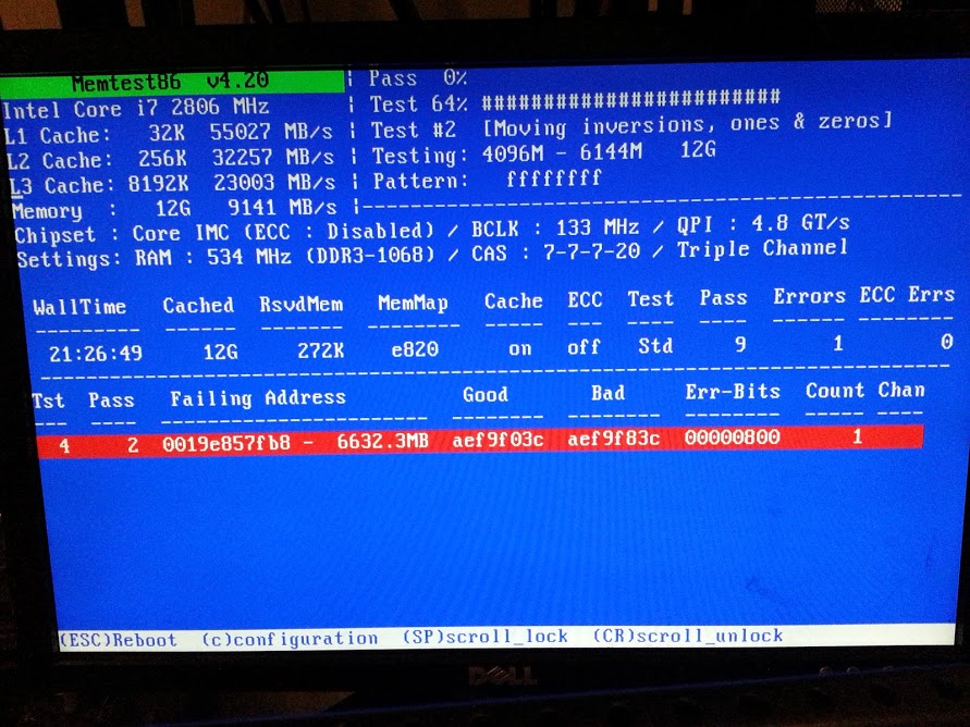

Since I'm essentially new to Memtest I'll let the screenshot speak up:
I do acknowledge that there is an error, though I am curious how serious it is. I completed 8 full passes and this error only came up once, on pass number 2. I am trying to read through Memtest's forums for a better understanding. How much memory (if any) is bad? Is there a way to isolate the bad stick without testing each one individually?
I have not conjured much new information testing my SATA disks in my Windows box. There are definitely two Seagate drives that I will RMA ASAP, though I am hoping they survive long enough for me to RMA them one at a time, so I can resilver my array once I bring it back online.
As for the backplane / SATA adapter cards, I will not be able to test them until tomorrow. I have a 1TB drive I am going to bounce around to see if there are any prominent errors stemming from simply connecting a disk and putting it under some I/O.
--- Update ---
Having (now) read the FAQ on Memtest's forums, I will dissect the memory error tomorrow. It seems like I'll be testing each module individually to determine if there's something wrong with a specific module, or whether the problem is elsewhere in the memory subsystem. I did double check memory compatibility with my mobo. It checks out according to ASUS.
That said, I am not yet convinced that memory is the root of this problem. I let Memtest run for a good long while and it only coughed up one error.
Hopefully this isn't another rabbit hole I have to climb down. But if it is, the c'est la vie!

Even 1 error can cause data loss if your data is in that location. It can cause instability too if code is being stored there and is not correct. There have been people that had a bad stick that caused a complete loss of data on their zpool despite having a RAIDZ2.
It's like your computer has alzheimer's and you never know if what the computer thinks is accurate or not.
This is where things get messy. It could be the RAM, motherboard, or CPU. Remember those memory locations are read from RAM, the signal passed through the motherboard to the CPU. Any part of that path can be the problem. Additionally, if its a RAM slot problem you may find it even harder to find the problem if you start testing 1 stick at a time.
Because of the way MEMTEST works its extremely unlikely that the issue was from cosmic radiation. Somewhere there was a cool calculation that the probability of memtest having a failure doing the test being a result of cosmic radiation exceeded the total lifespan of the known universe(13.7billion years).
At the very least, you have some kind of hardware issue. At the worst it could be an indicator of the problems you were having, but may not be the cause.
Issues that show up on memtest are pretty much an indicator of a system that shouldn't be trusted to do anything until fixed.
I believe Linux allows you to block certain known bad memory locations. Not sure about FreeBSD though, and not sure if FreeNAS has that function. Considering that RAM is covered by a lifetime warranty there really isn't any good reason not to do an RMA :P
