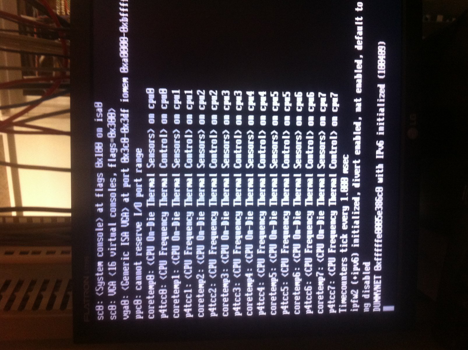

I have a server running on the latest 8.3.x version and everything works fine.
I tried to update to 9.1.1 but than it stops while booting at dummy net ipv6.
And it is standing still. No panic. Nothing.
So I though I should do a clean installation.
Same problem.
Does anyone know maybe how to fix it? I can also post a screenshot of the whole monitor output, maybe are some information which I think they are not important.
Thanks!

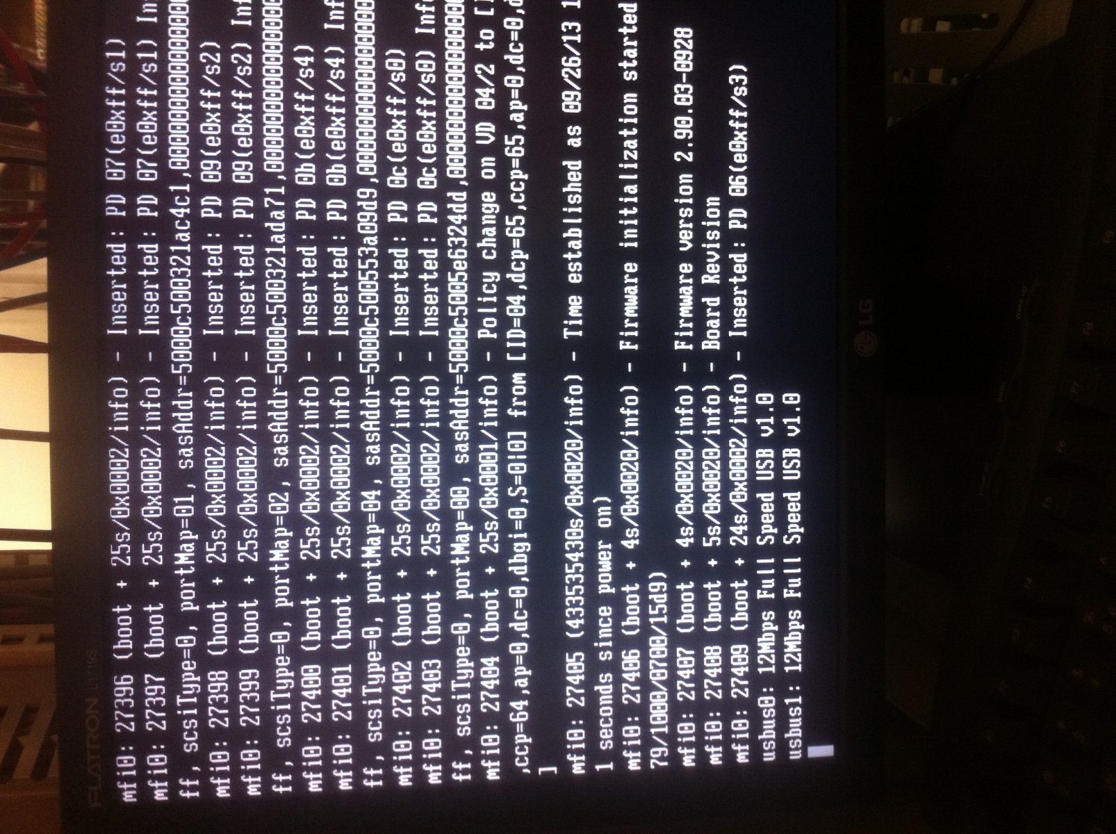

So...
it is an S5000PAL Intel Board with XEON CPUs and 32GB Ram.
I tried tomorrow to update the bios, but its strange, that 8.3.1 is running without any problem, but 9.xx not
Sometimes it hangs at 1 pictures, sometimes on second. But it never goes further than this.

You were a little skimpy on your system description. Nothing about hard drives, how they are connected to the system, flash drive info, etc... Sometimes the smallest thing is the thing that helps us figure it out for you.
Also, next time rotate your photos please.
If you have data on your hard drives you might consider disconnecting them while you are trying to fix this. Once you can boot it up, you can then consider reconnecting your hard drives. It would be bad if you lost your data by accident.
Try to install 9.1.1 again on a different flash drive (4GB size at least), clean install. You might try putting the flash drive into a different USB socket as well. And I assume you are using the 64 bit version.
Something else you can try, run MemTest86 for 3 complete passes using default settings.
