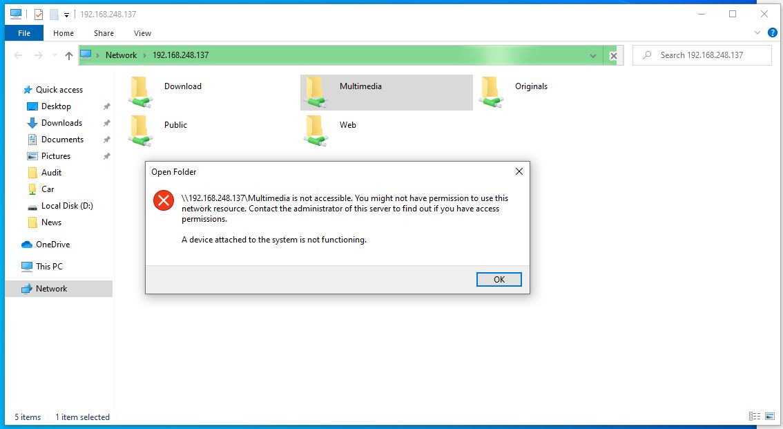

I have a QNAP TS-x53B Series with 10TB x 5 IronWolf Bios Ver Qy59AR09 (4.4.2(20200519) One of my HDD is showing fail when i try to access the NAS it is throwing the following error .How can i retrieve me old data ?Need you advice.

Hello Rajan. This forum is for TrueNAS/FreeNAS software, not QNAP devices. Perhaps you might have more luck with answers on the QNAP Forum at https://forum.qnap.com/
Good luck with getting to your data.
