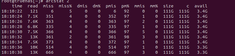

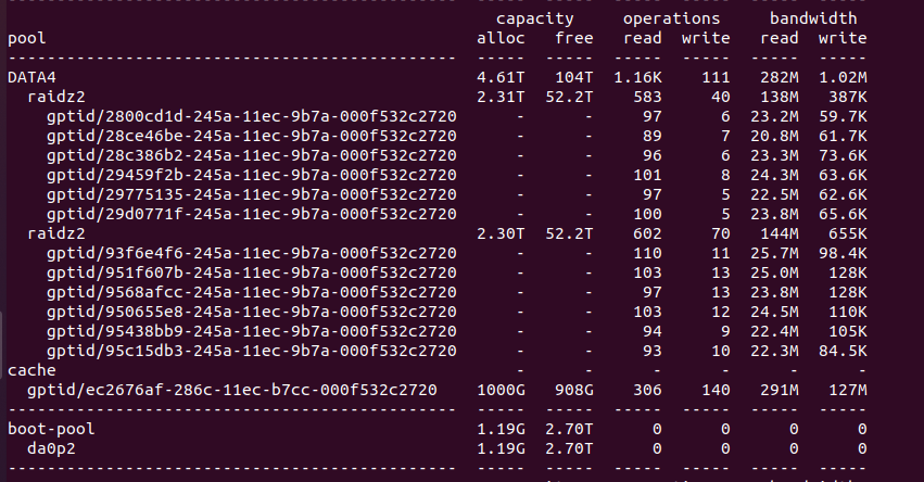

ssd has been filling up nicely and the zpool iostat says it's reading 200MB/second - but the net output hasnt changed - as if the ssd read was wasted.
make anysense ?

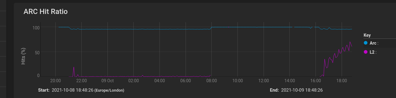

l2 arc hit ratio eventually reach 90% after I limited the working set to strictly less than the l2arc size.
the ssd is now being read at 480MB/sec which is close to its read limit.
i guess if i wanted to saturate the 10gig nic I would need two of them - is that sound reasoning ?
